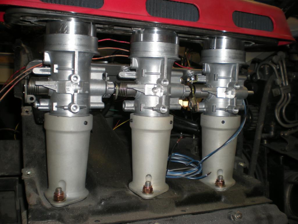

Those are Jeffs, but it's a mount. It ties the three TBs together. The spacing on the Polaris TBs is just a little off. So the mount that comes on them won't work.

QUOTE(McMark @ Nov 17 2013, 09:07 PM) *
Mark, It looks like the TB's are attached to the printed intakes with set screws. I'm still thinking of using these with my Datsun L28 motor. I think these could be tied together with a heat shield under the TB's and over the header?

QUOTE(ConeDodger @ Nov 18 2013, 08:04 AM) *
They are aluminum, and will be sealed in with 890 sealant from expired product from work. set screws are just extra.
Mark mine are still 116mm the two outer intakes stacks are angled in. The stainless perf. was leftover, just tried something different. I also removed the coolant passage
bosses.

McMark   Those are Jeffs, but it's a mount. It ties th...   Nov 17 2013, 11:07 PM
ConeDodger   Those are Jeffs, but it's a mount. It ties t...   Nov 18 2013, 10:04 AM
sixnotfour   Those are Jeffs, but it's a mount. It ties ...   Nov 18 2013, 02:43 PM
