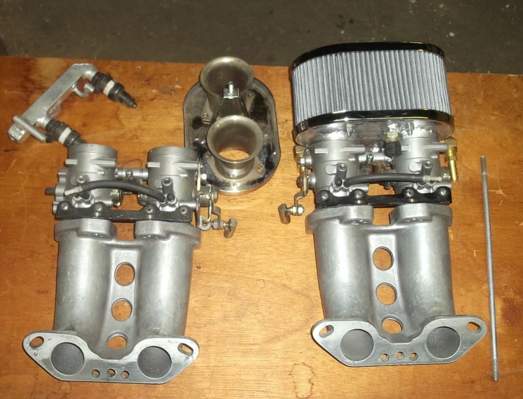

I need some TB's for my 914/4 type 4 into bug project engine.
Jenvey, Extrudabody and TWM TB's are crazy frickin' expensive for what they are, so I'm going the Motorcycle TB route.
This is what came in the mail today, stuff looks real good (IMG:style_emoticons/default/piratenanner.gif)

I was making good progress, but work got in the way. Now I'm hoping to have both my bug and 914/6 project done for the spring. But I do have several jobs for others that have to be done as well.
This is my progress on my ITB project. this was originally for my 914 but now it's going in my 67 bug.

Mark Henry   I was making good progress, but work got in the wa...   Nov 21 2013, 07:38 PM
Mark Henry   ITB without filters   Nov 21 2013, 07:40 PM
Mark Henry   ITB with filters   Nov 21 2013, 07:41 PM
Mark Henry   down the throat. I am having issues with clearanc...   Nov 21 2013, 07:46 PM
