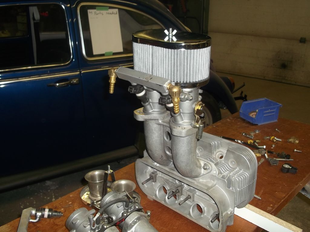

I need some TB's for my 914/4 type 4 into bug project engine.
Jenvey, Extrudabody and TWM TB's are crazy frickin' expensive for what they are, so I'm going the Motorcycle TB route.
This is what came in the mail today, stuff looks real good (IMG:style_emoticons/default/piratenanner.gif)

ITB with filters

Mark Henry   I was making good progress, but work got in the wa...   Nov 21 2013, 07:38 PM

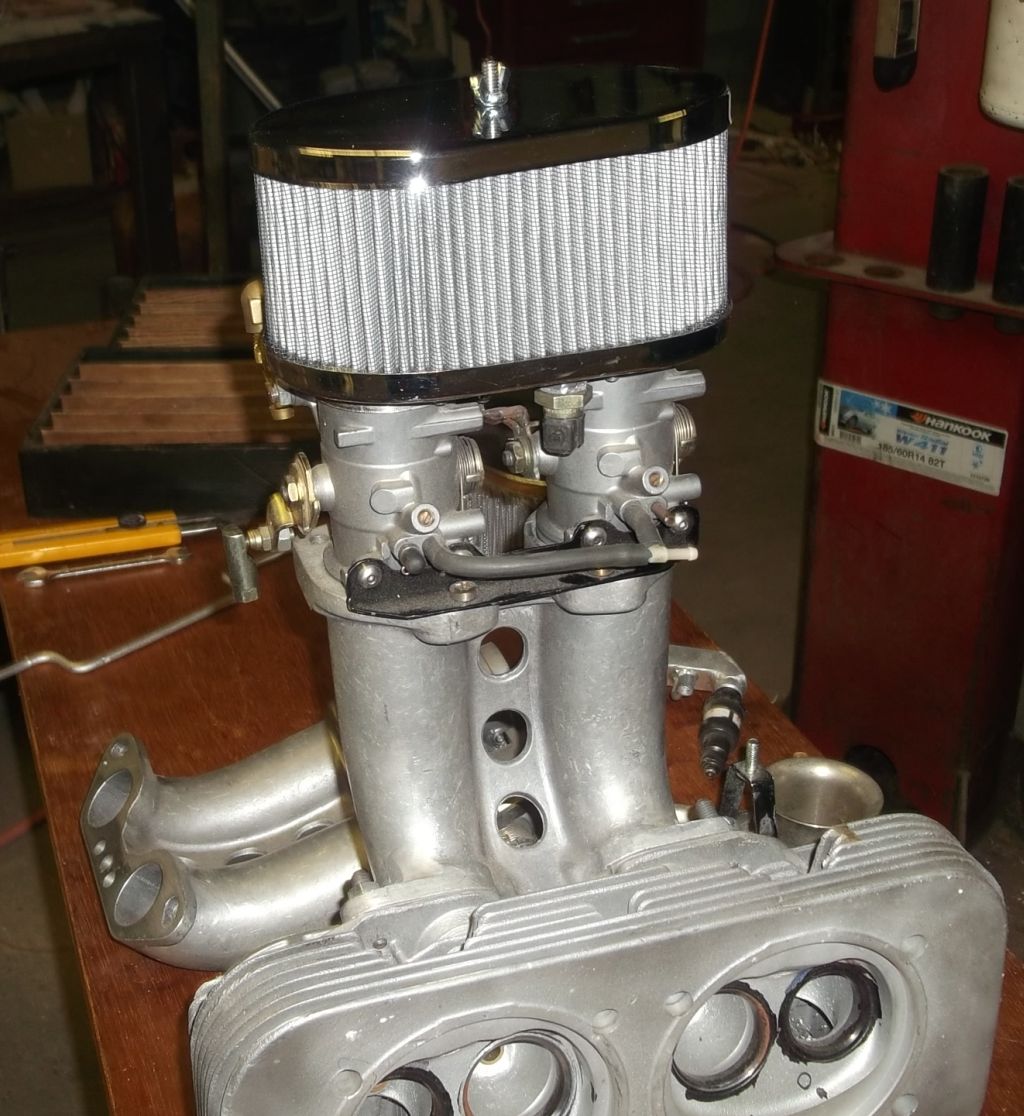

Mark Henry   ITB without filters   Nov 21 2013, 07:40 PM
Mark Henry   ITB with filters   Nov 21 2013, 07:41 PM
Mark Henry   down the throat. I am having issues with clearanc...   Nov 21 2013, 07:46 PM
r_towle   Flip them, put the rail in the inside   Nov 21 2013, 08:50 PM
Mark Henry   Flip them, put the rail in the inside You reall...   Nov 21 2013, 09:50 PM
Dr Evil   Mark, you need to place them so that air will past...   Nov 21 2013, 10:15 PM
Mark Henry   Mark, you need to place them so that air will pas...   Nov 21 2013, 10:20 PM

Mark Henry   I did some re-profiling on the 1/2 side fuel rail ...   Nov 27 2013, 09:23 AM
