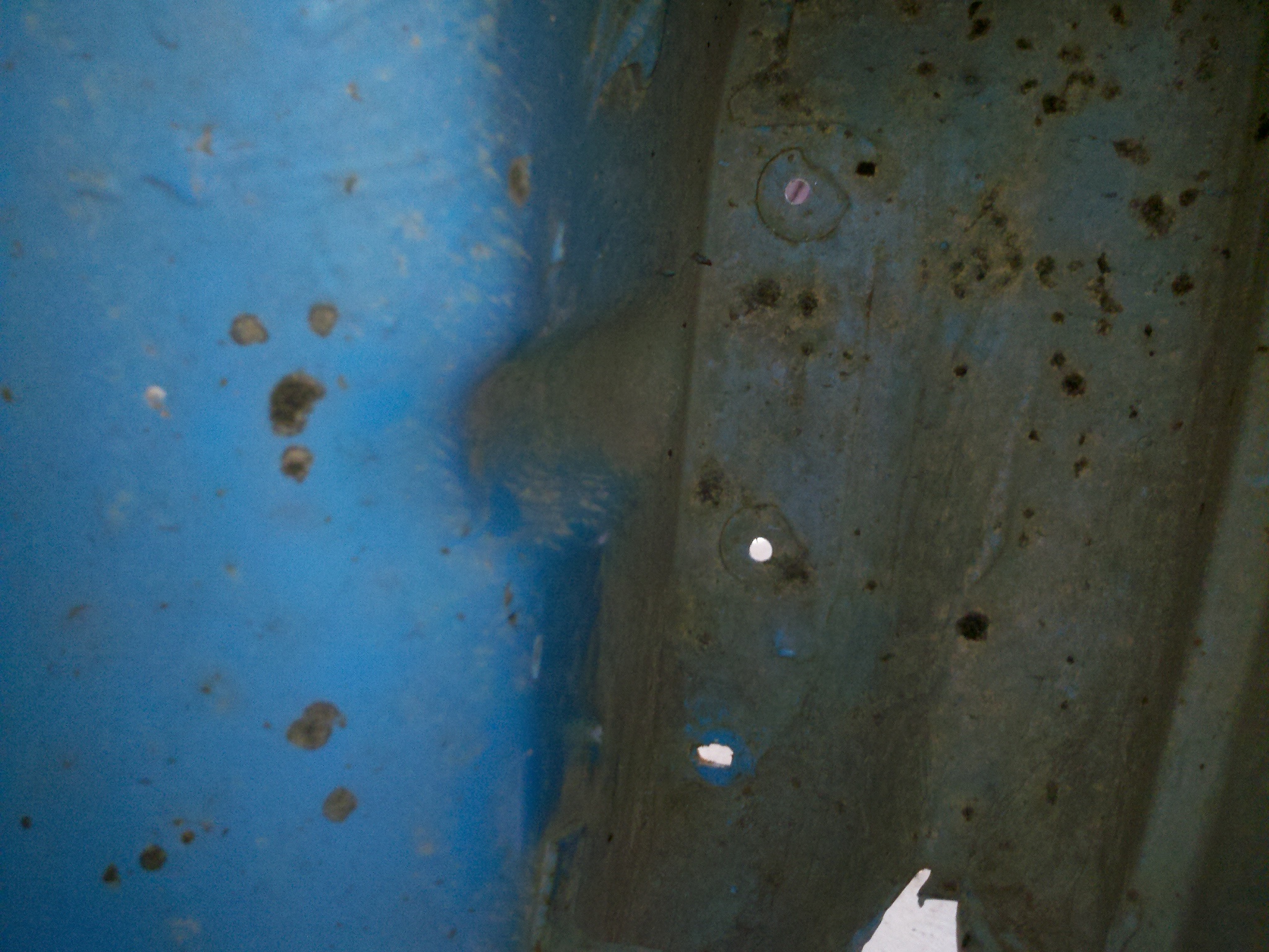

Now for the fun part. You will need to remove those retaining rails from each side of the car. They are spot-welded on in 5 or 6 spots. There are a couple of ways to do this. You can use a grinder or cutting disc to grind through the welds, or you can buy yourself a spot weld cutter to drill them out. Or if you are an idiot like me, you can attempt to use a regular drill bit and drill them out, and then weld up the resulting holes. I bought a spot weld cutter before I did the front.
I forgot to take pictures of the rear, but here is one of the front – same procedure for both.
As far as the bodywork required to touch these areas up, I welded up the holes and ground it flat. I then taped off the area, primed it and used a rattle can of a fairly close blue that I found at Lowes. When the bumper is installed, these areas don’t show much, but they still needed to be painted.

Remember how I said the holes were already there, sort of? Well they are, but you need to make them go all the way through. If you look inside the wheel well, you will see that there is a reinforcement plate with two holes that was welded in at the factory to support the early bumpers. Why they continued to put them in on late cars, I don’t know, but it works out in our favor. All we need to do is punch or drill the center of these holes and drill them out to 5/8.
