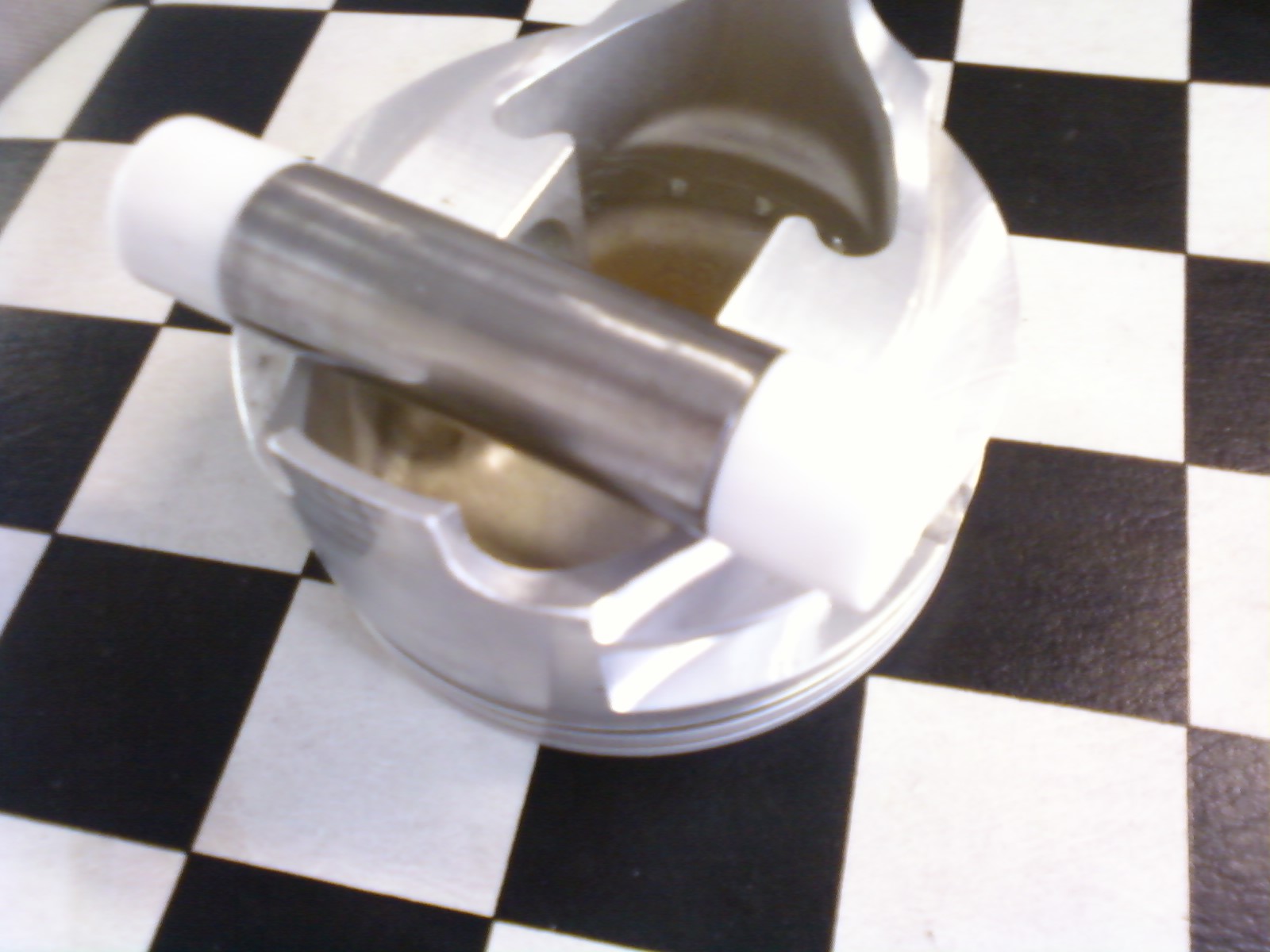

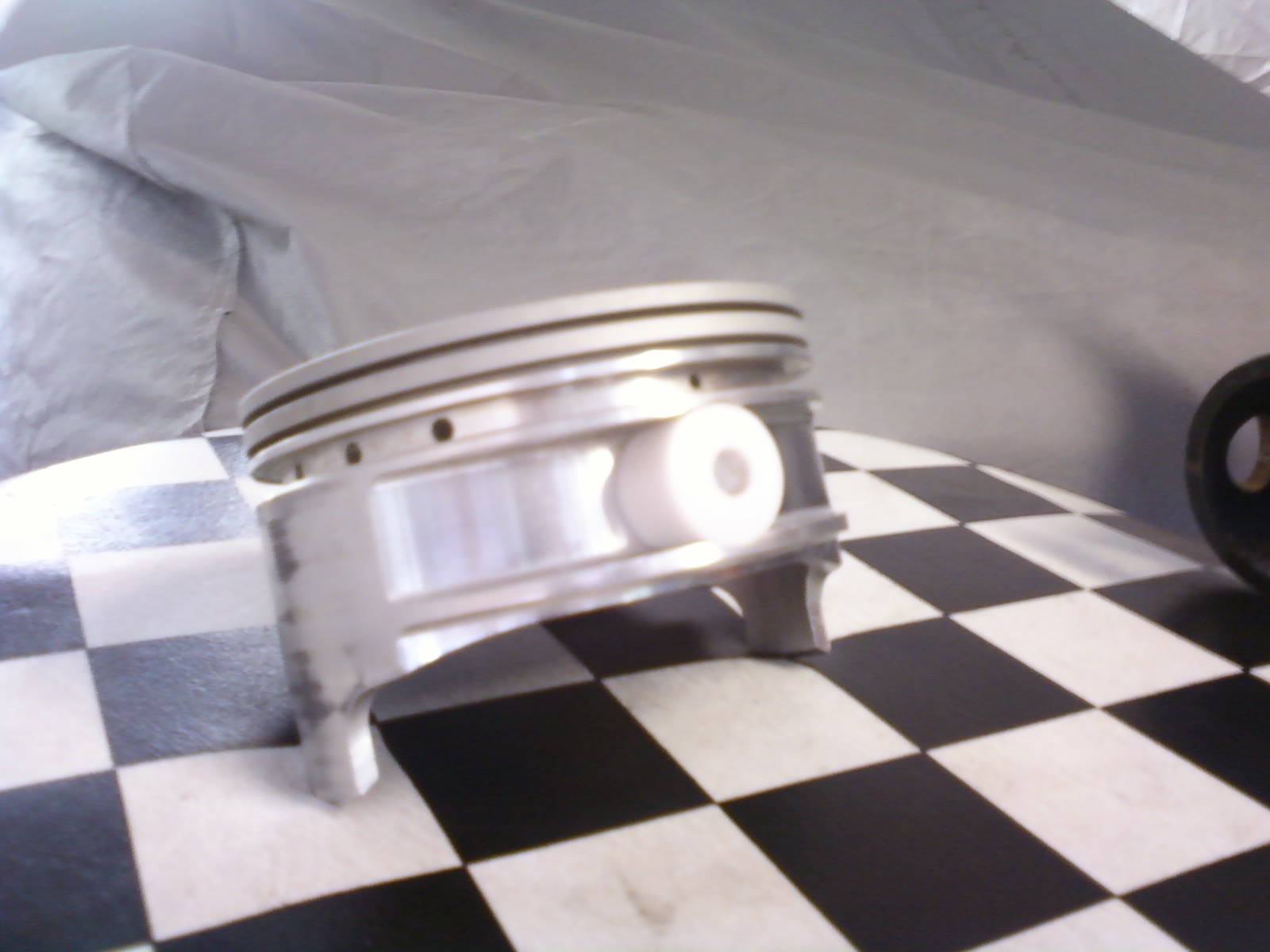

Bills914-4
post Nov 26 2013, 08:16 PM
Posts: 313
Joined: 1-March 08
From: suburbs of Miami FL.
Member No.: 8,762
Here's some pic's of the pistons I'll be using ,some oldschool Aria's 103mm I picked up on the samba last year ( collecting parts for awhile (IMG:style_emoticons/default/biggrin.gif) ) price was right (IMG:style_emoticons/default/smile.gif) ,
they didn't have grooves for the clips so I made some Teflon buttons (ptfe, McMaster) , thanks for looking Bill D.
