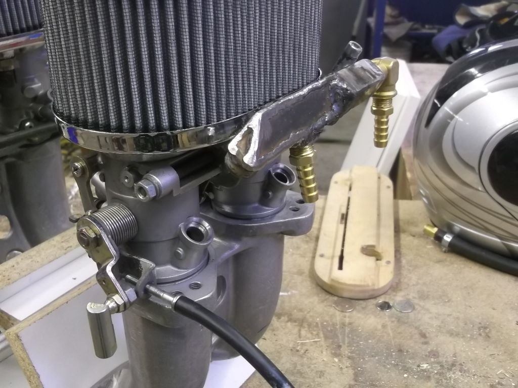

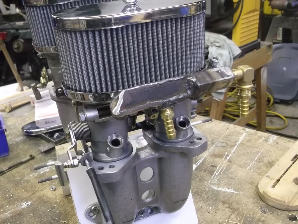

I did some re-profiling on the 1/2 side fuel rail for clearance.

Mark Henry   I did some re-profiling on the 1/2 side fuel rail ...   Nov 27 2013, 09:23 AM
