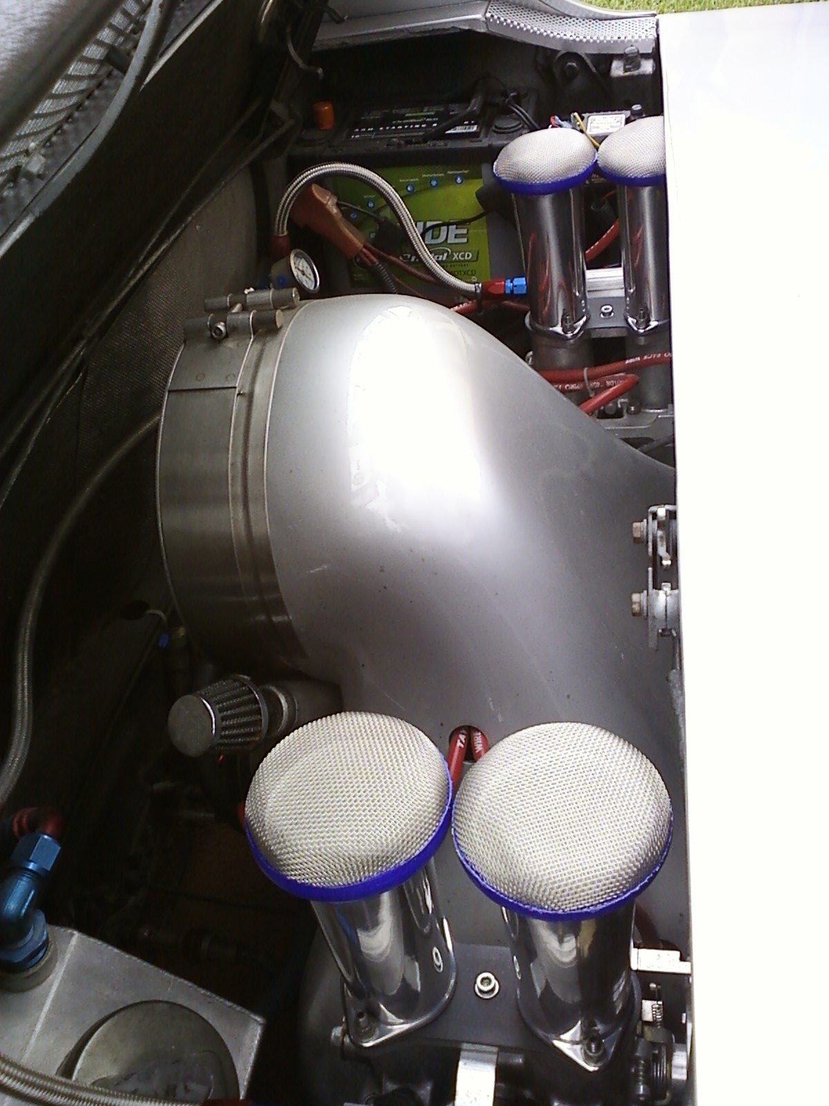

Here's a few pic's of my planned conversion to twin plug with a Pauter cam (IMG:style_emoticons/default/smile.gif) , &
either MSII or MegaJolt with edis4 x 2 for ignition, Bill D.

Beautiful set up--love the velocity stacks--old school "Pornsche".
WATCH OUT during assembly of the fuel rails & injectors that you don't leave out the little clips that retain the injectors into the rail. Mine were left out such that the only thing holding it all together was the screw from underneath pushing the rail down onto the injectors. Screw worked loose, engine started misfiring at VIR on back straight, found fuel spraying copiously from driver's side rail and the hell hole under the relay box FULL of fuel because a stray 10mm tin screw was blocking the drain hole and the fuel had even seeped through into the carpeting on the left side of the driver's seat. Anyone with the CB injector rails please take note! BTW, I'm a fan of SFI rated fire suits now...
