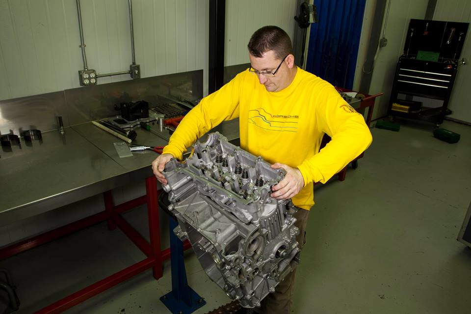

If you guys had any idea how many M96/97 engines Jake's company Flat 6 has built it would probably blow your minds.
We were doing it well before anyone even knew it, too. Thats the benefit of working in the middle of no where and keeping the place locked down like a military compound :-)
Hell, Blake and I built another one M96 this week.. This one was for a slightly different purpose, though… To gain the photos for the step by step assembly portion of my book, "The M96 Definitive Guide"
I owe Blake a big favor, he picked up my slack on Sunday and Monday's photo shoots while I was laid up at home with the nastiest case of the stomach flu on the planet. Here's some photos from the shoot :-)
This photo was taken about 5 minutes before I started puking my guts up! I was so delirious that I installed the crankshaft into the carrier backward!
(IMG:http://www.914world.com/bbs2/uploads_offsite/scontent-b-atl.xx.fbcdn.net-1095-1386379663.1.jpg)

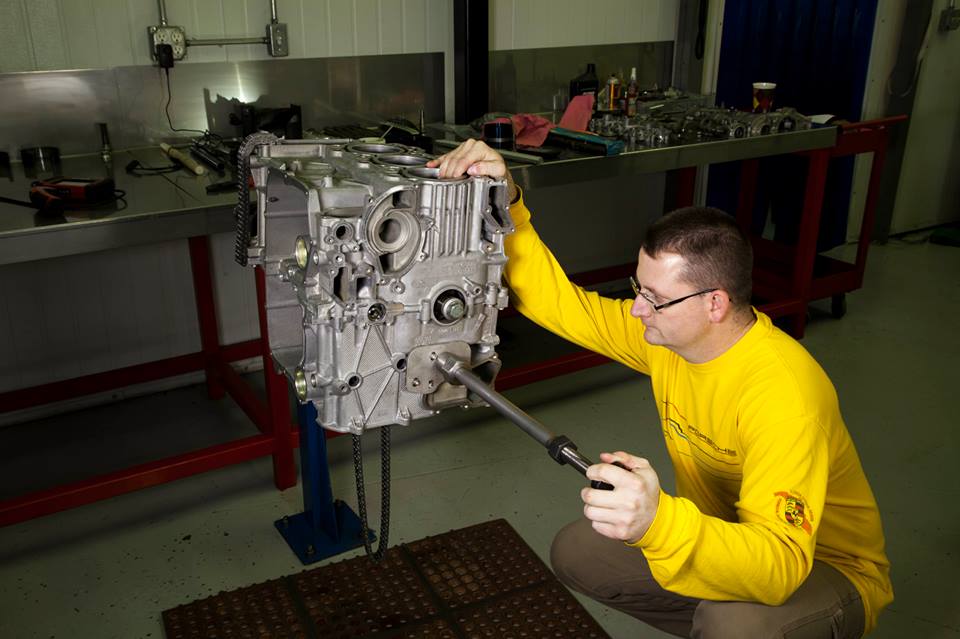

Here's the never before released photo of the Patent pending Raby faultless piston pin and clip tool for the M96 engine.
(IMG:http://www.914world.com/bbs2/uploads_offsite/scontent-b-atl.xx.fbcdn.net-1095-1386379665.2.jpg)

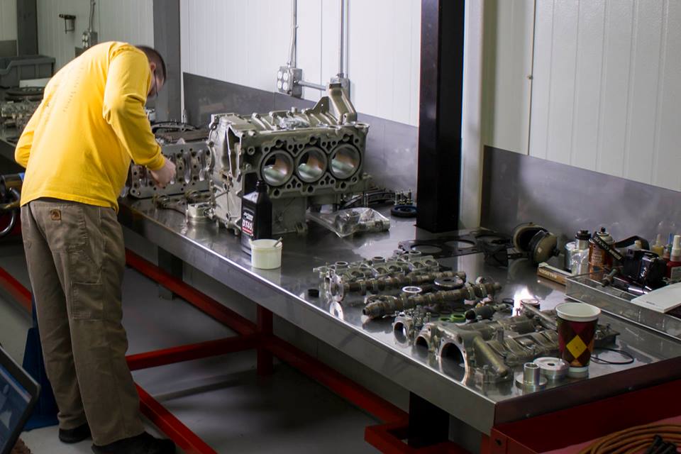

Installing a cylinder head… That was previously cracked onto this 2003 Boxster S engine! Repaired by Len, of course!
(IMG:http://www.914world.com/bbs2/uploads_offsite/scontent-b-atl.xx.fbcdn.net-1095-1386379665.3.jpg)
Nick Czerula shot over 1500 photos of engine assembly this week, and a couple of me for the book, too. Here's one of them… Nick can make anyone look good!
(IMG:http://www.914world.com/bbs2/uploads_offsite/scontent-b-atl.xx.fbcdn.net-1095-1386379666.4.jpg)
