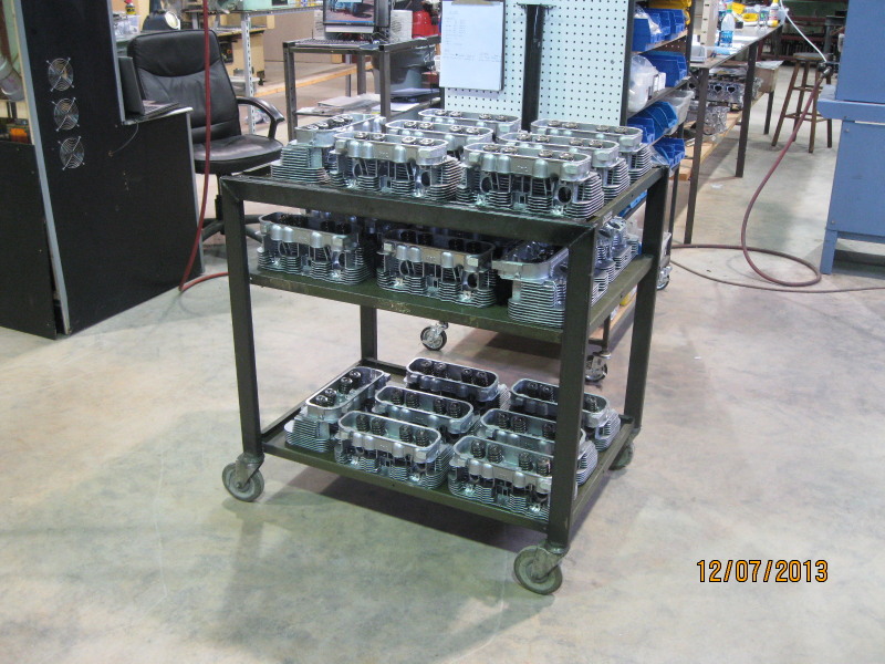

Off topic, but thought it worth while since this is at it's heart an aircooled site.
Still a butt load of T4 engines coming off the hill in Cleveland, GA too! These heads are all for one engine batch, and that's not all of them. The complete order wouldn't fit on the cart! Attached Image
