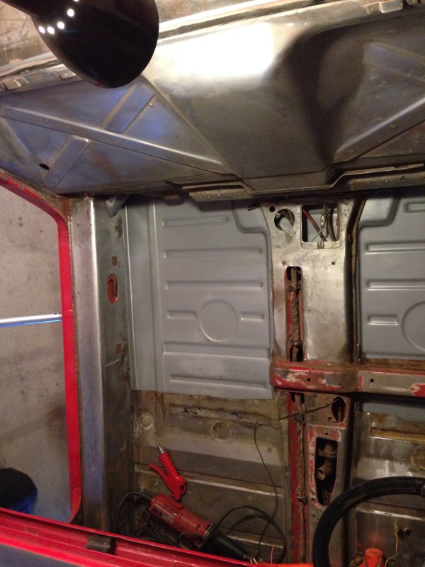

Put in another hour today removed quite a bit of floor pan getting close to trimming it. then I will finish prepping the interior and move on to the firewall I am going to bolt the tub to the cellete at our shop before I start welding.. I was talking to our Fabricator at Jerry Woods and he explained a similar way of doing it Id love to see some photos if you have some... Here is a photo update
(IMG:http://www.914world.com/bbs2/uploads_offsite/img.photobucket.com-9738-1386451791.1.jpg)
