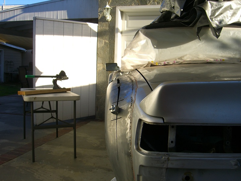

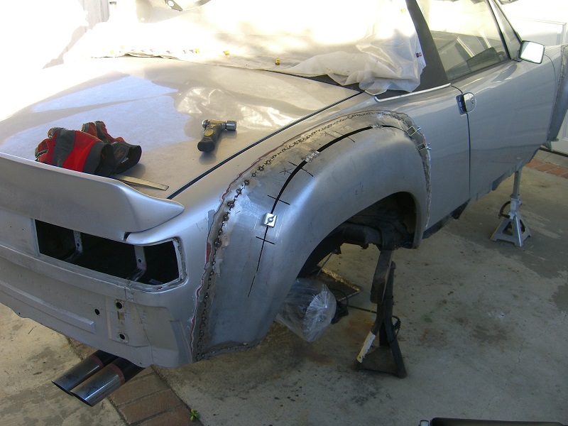

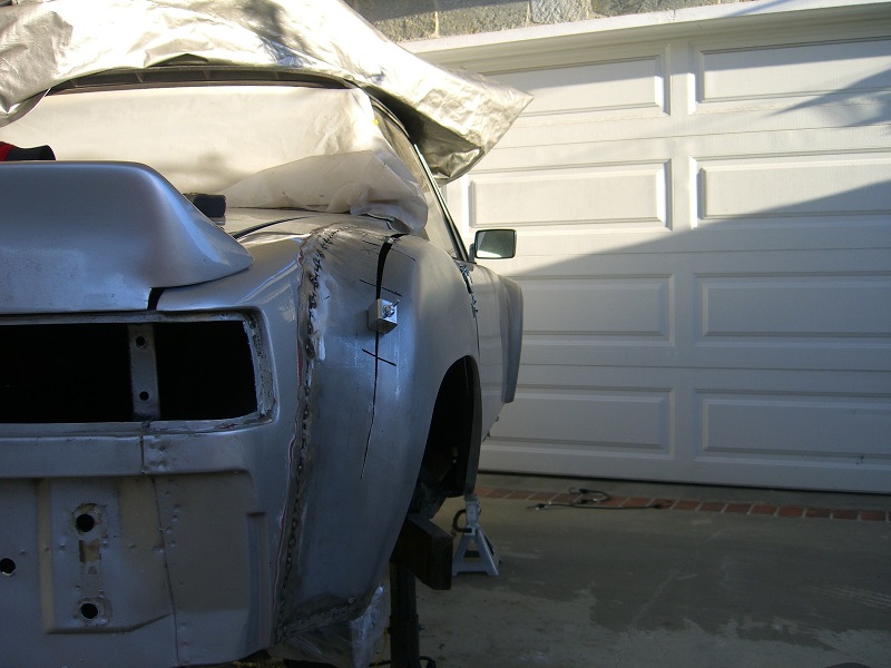

Here are some pics of my rear flare 'widen' process (IMG:style_emoticons/default/smile.gif). For some reason I thought I took a lot more pictures of this. I may have to check my other SD card.
But these illustrate the basic idea of what I did. On the third picture, you can see how much better the rear outer shape matches the front, due to the 'widening'. Also in that pic you can see the hand shear I used, to cut the strips that filled the gap I created. I hope this helps (IMG:style_emoticons/default/smash.gif)
