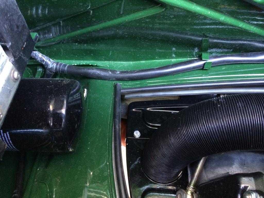

Car is back and has a fully rebuilt 2.0 now. Wow, that was expensive. In general, I've discovered that the less horsepower a Porsche engine makes, the more expensive they are to rebuild. Strange.
Anyways, doesn't it look like the engine is sitting too low?
-Steve

siverson   Car is back and has a fully rebuilt 2.0 now. Wow, ...   Dec 9 2013, 12:02 PM
siverson   914   Dec 9 2013, 12:02 PM
siverson   914   Dec 9 2013, 12:03 PM
JmuRiz   Yep, it's sitting too low, check to see which ...   Dec 9 2013, 12:27 PM
