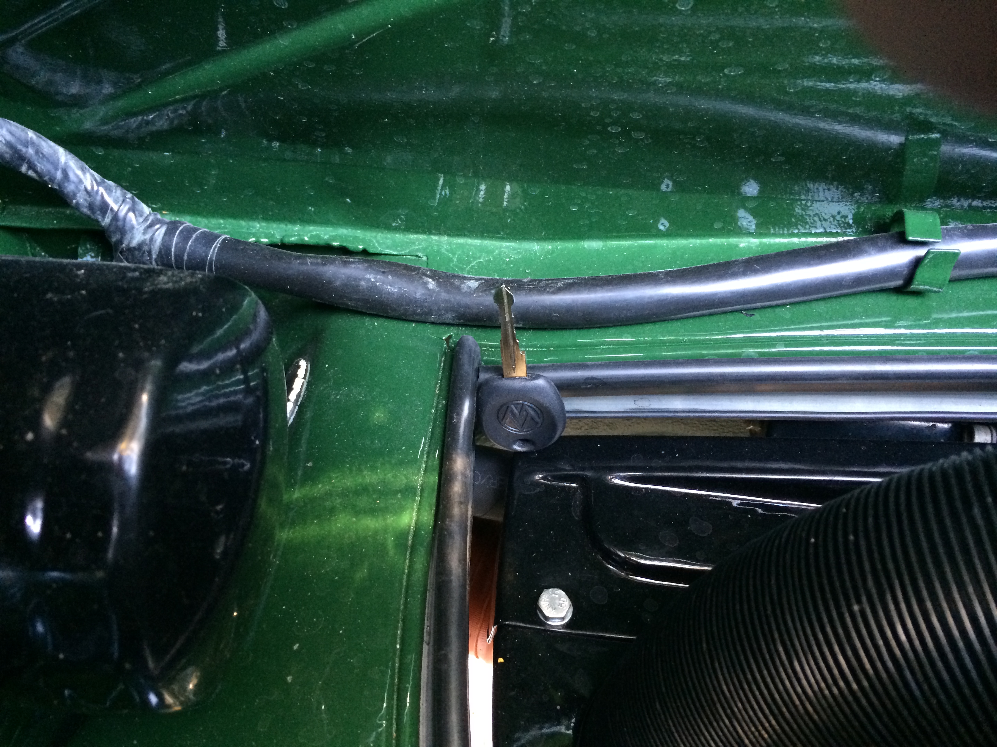

siverson   I haven't seen this before. Maybe it's jus...   Jan 5 2014, 11:24 AM
siverson   The wires were embedded in it a bit... -Steve   Jan 5 2014, 11:29 AM

mepstein   :confused: what your showing in the pic should j...   Jan 5 2014, 11:34 AM
siverson   > what your showing in the pic should just peel...   Jan 5 2014, 11:36 AM
rick 918-S   That's weird about the carpet holders....   Jan 5 2014, 11:50 AM

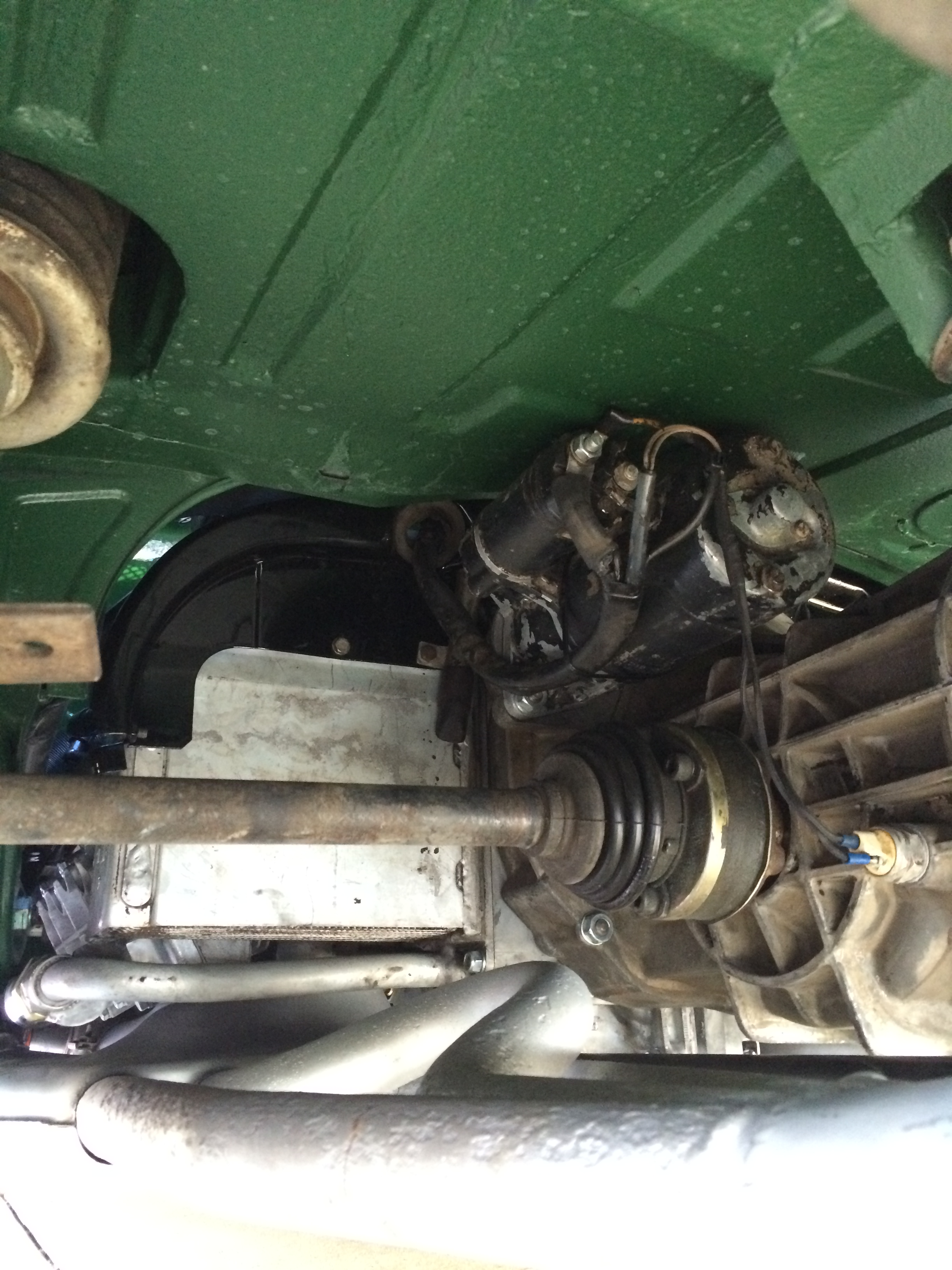

siverson   One spray painted horn, one not. And... are these ...   Mar 7 2014, 10:13 PM
siverson   Removed old aftermarket sway bar. Anyone know what...   Mar 7 2014, 10:15 PM
siverson   Green, white overspray, and original 914-6 grey st...   Mar 7 2014, 10:17 PM
siverson   All four calipers removed and ready to be restored...   Mar 7 2014, 10:18 PM
siverson   Nice... I'm pretty sure these are the original...   Mar 7 2014, 10:20 PM
