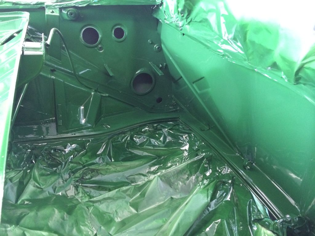

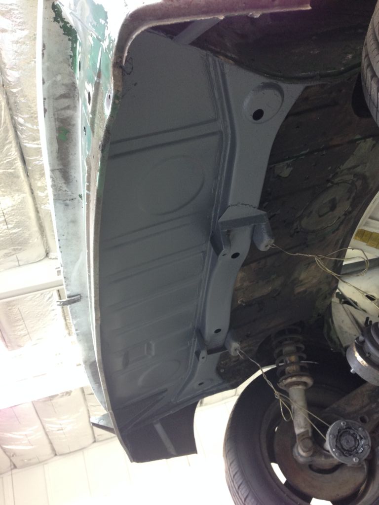

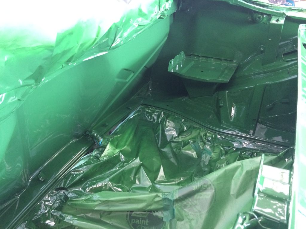

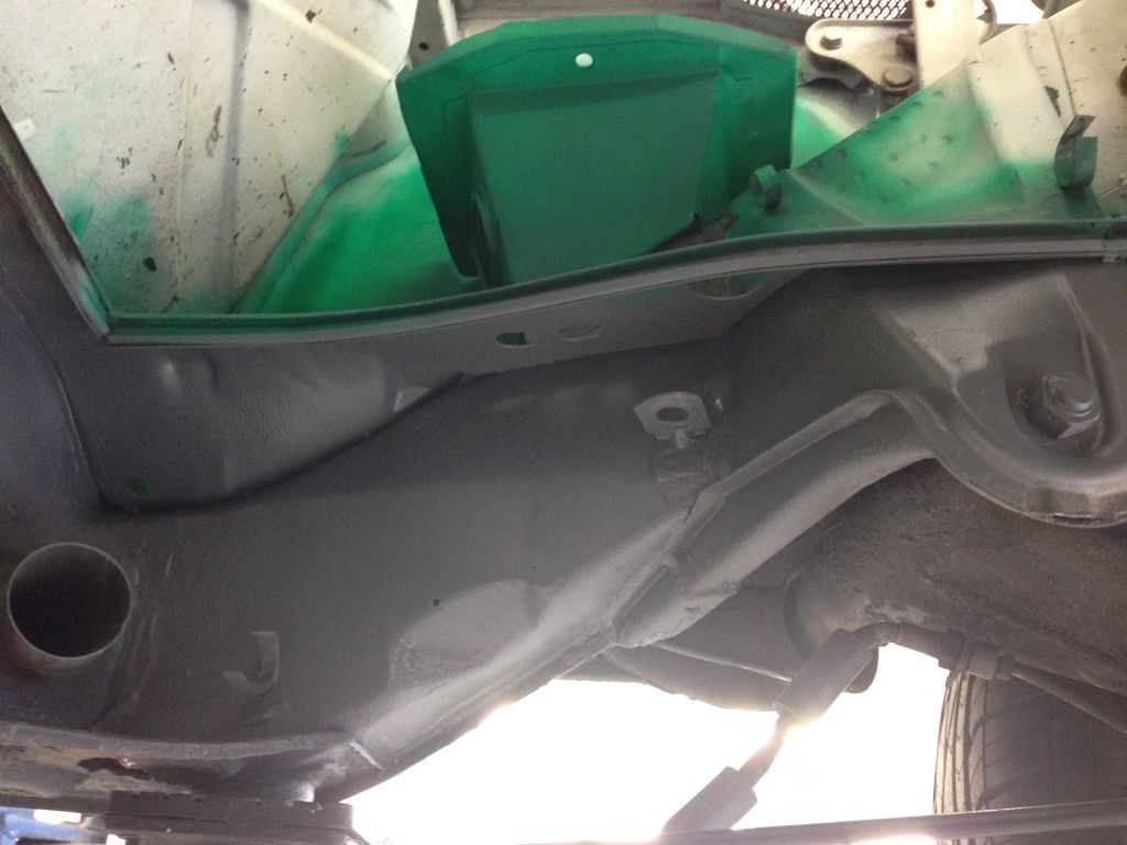

siverson   And some more photos... (before and after) It...   Dec 9 2013, 01:18 PM

rick 918-S   > And I have decided to paint the whole bottom...   Dec 9 2013, 01:52 PM

JmuRiz   Very cool updated pictures, the change back to iri...   Dec 9 2013, 02:15 PM
Cairo94507   I agree with you 100% regarding the underside of t...   Dec 10 2013, 08:55 AM

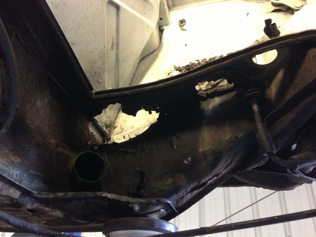

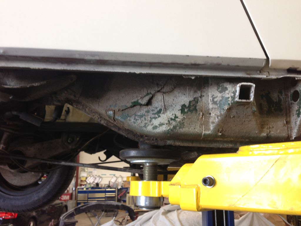

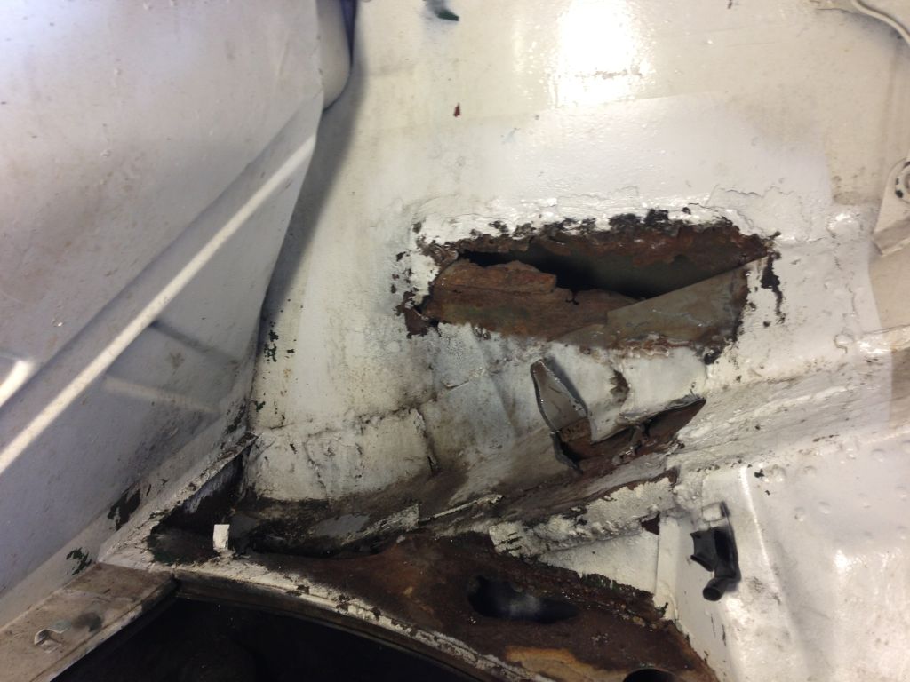

siverson   I got these photos from the body shop today... Th...   Dec 19 2013, 11:47 PM
siverson   And the battery box area repair. Anything the exp...   Dec 19 2013, 11:58 PM
siverson   And the repair...   Dec 20 2013, 12:00 AM
siverson   914   Dec 20 2013, 12:01 AM
siverson   914   Dec 20 2013, 12:03 AM
rick 918-S   Nice! There moving right along! :sawzall: ...   Dec 20 2013, 06:36 AM
JmuRiz   I think it's safe to say they are all rusted o...   Dec 20 2013, 08:31 AM
