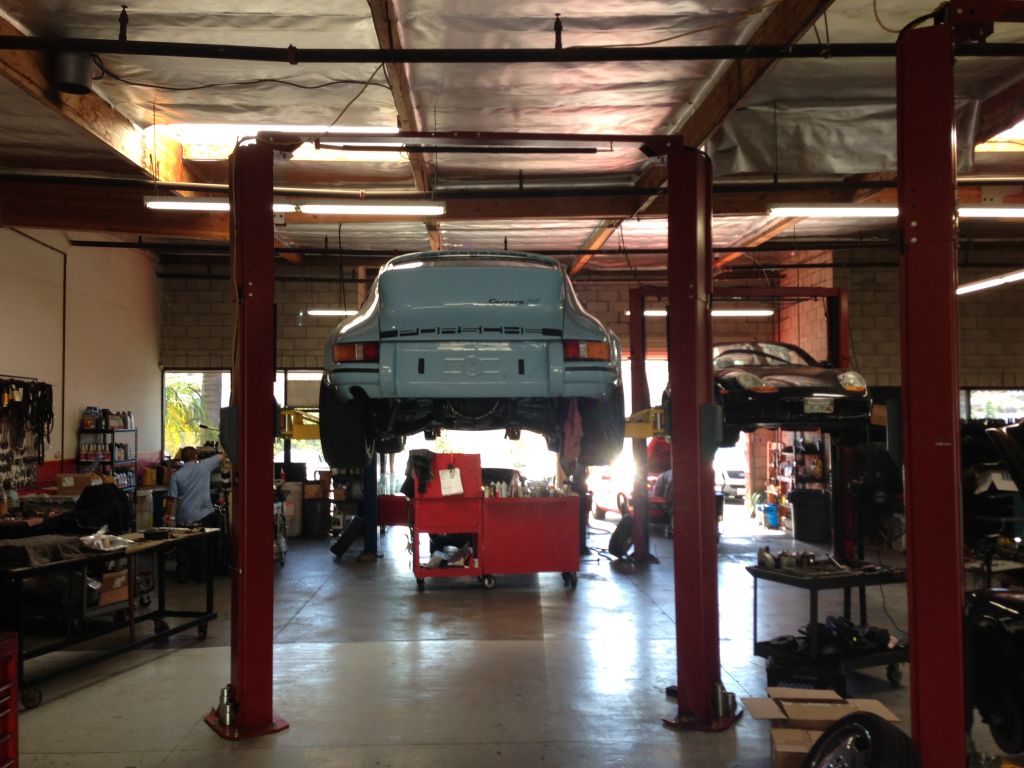

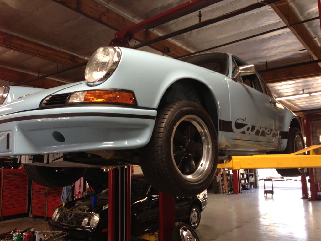

siverson
post Dec 9 2013, 01:41 PM
Posts: 2,464
Joined: 5-May 03
From: San Diego, CA
Member No.: 654
This was his roommate while getting worked on (it's real).
-Steve
