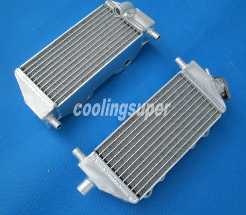

I'm having one hell of a time locating a radiator anything close to the one you have. I started thinking about a compact sized radiator, and that took me to looking at two smaller radiators. I think the Boxster does something like that too.
What do people think about using two smaller motorcycle or quad radiators.
I could mount two of these, and put the Intercooler radiator in between them...all up front without taking up too much room.
