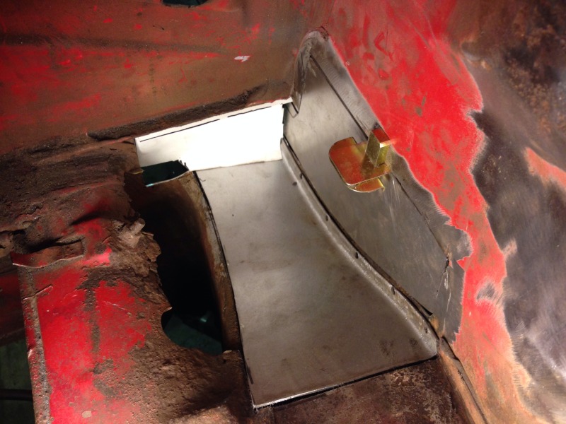

ONTHEGRIND   What should I spray inside the longs before I weld...   Dec 14 2013, 12:14 PM
Krieger   3M had a product called Weld Thru II that is suppo...   Dec 14 2013, 12:47 PM
ONTHEGRIND   Sweet I will try that.   Dec 14 2013, 01:23 PM
gothspeed   I think Napa has 'weldable primer' on the ...   Dec 14 2013, 09:08 PM
ONTHEGRIND   I have some weldable primer but was thinking about...   Dec 14 2013, 11:32 PM
gothspeed   I have some weldable primer but was thinking abou...   Dec 15 2013, 02:32 AM
ONTHEGRIND   bolted up the floor then trimmed the existing p...   Dec 15 2013, 08:38 PM
gothspeed   Looks fantastic :)!!! ....... maybe ro...   Dec 15 2013, 08:53 PM
ONTHEGRIND   yeah I made a few of those patches I going to see ...   Dec 15 2013, 11:27 PM
