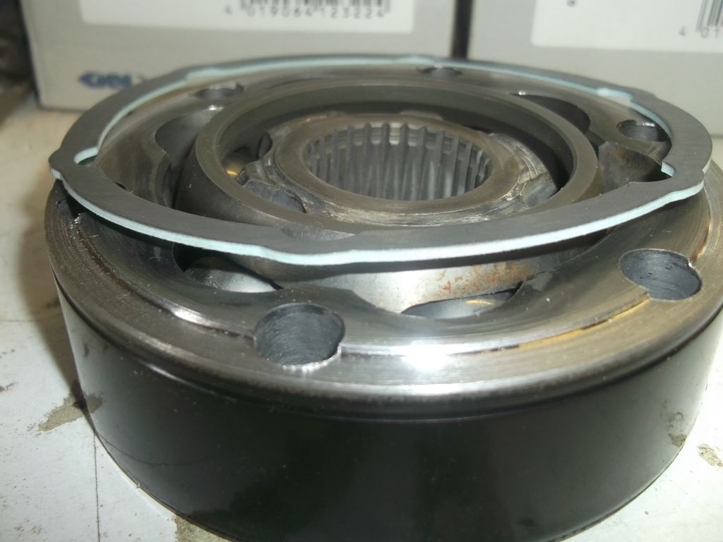

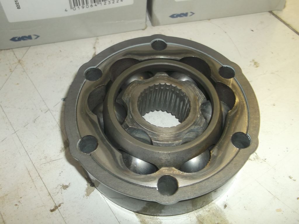

I was going this route, but I'm thinking of using the later G50 CV, mainly because I'm a CSOB (would save me $150) and I should be able to figure out a solution for the gasket/end cap issue.
The G50 is 6 bolt X 10mm and has no relief for a gasket, but is suppose to be the same in all other regards.
http://forums.pelicanparts.com/porsche-911...patibility.html
Part number for the G50 CV is 911-332-923-01-M60
http://www.pelicanparts.com/cgi-bin/ksearc...-332-923-01-M60
(IMG:http://www.914world.com/bbs2/uploads_offsite/forums.pelicanparts.com-26-1372786441.1.jpg)
(IMG:http://www.914world.com/bbs2/uploads_offsite/forums.pelicanparts.com-26-1372786892.1.jpg)
(IMG:http://www.914world.com/bbs2/uploads_offsite/forums.pelicanparts.com-26-1372786892.2.jpg)
Only real issues is the 6 bolt 10mm vs 4 bolt 2 pin and no gasket. It looks like the 928 cap will not fit into the early flange/stub.
(IMG:http://www.914world.com/bbs2/uploads_offsite/forums.pelicanparts.com-26-1372786893.3.jpg)

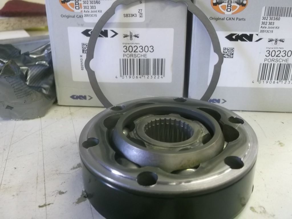

This is my solution, the late model G50 CV's that I have modified to accept the stock grease seal
The CV material was very hard (flame hardened) and could only be cut with carbide tooling.
I'll stick a length of rod in the 2 extra bolt holes to capture the roll pins, I may have to spread the roll pin slightly to ensure a tight fit in the CV.
Other than that it should fit like stock '74 CV's now, it will no longer need the 928 grease cap.

PRS914-6   More comparison photos. You can clearly see the a...   Aug 22 2013, 09:18 PM

Eric_Shea   CV Gaskets? Pretty common for say... a 1970 911.   Dec 13 2013, 01:44 PM
Mark Henry   CV Gaskets? Pretty common for say... a 1970 911....   Dec 13 2013, 01:54 PM
KTL   Instead of machining the CV and using the gasket, ...   Dec 18 2013, 09:53 AM

Mark Henry   Instead of machining the CV and using the gasket,...   Jan 15 2014, 02:03 PM
KTL   Instead of machining the CV and using the gasket...   Jan 15 2014, 03:09 PM

Eric_Shea   No, you can see the two pins sticking out clearl...   Jan 16 2014, 10:13 AM
Mark Henry   Ok some pics on thisfirst it's not just a ...   Jan 19 2014, 11:25 PM
Mark Henry   Difference in shaft lengths between the 1970 901 f...   Jan 19 2014, 11:27 PM
Mark Henry   This is the 1970 911/901 flange sitting in a 914-9...   Jan 19 2014, 11:31 PM
