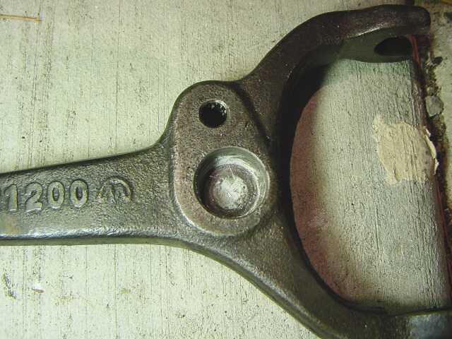

Hey guys, I need some help with a release fork/pivot shim issue I have run into.
I am working on reinstalling my transmission after my lost driveshaft incident.
I have a new clutch release fork that I installed, and I noticed that when I stuck the transmission back on the engine, the fork doesn't have more than a few mm of free play before it hits the transmission housing. So I think hmmm and I pull it back apart.
Then I think back to the last time I did this, I put in a new cup in the old throwout arm. At that time I noticed the ball cup stuck way out of the fork and I had to actually trim it down to fit. I thought it was weird but blamed Brad on giving me crap parts (just kidding Brad). I even took a picture, shown below.

Keeping that in mind, I thought hmmmmmm maybe that has something to do with my problem. I got out the old clutch fork and pulled the cup out of it. Then I noticed something. The height of the cup in the fork was different between the old fork and the new one! Inside the fork there was a bunch of JB weld, and under the JB weld was a stack of washers!!!
Here is what I saw (f'ing DAPO!!!):

SirAndy   <...   Jul 30 2004, 03:15 PM
jkeyzer   It wiggles a lot. At least 15-20 mm. That is the...   Jul 30 2004, 03:18 PM
SirAndy   bend here, towards the engine (away from the trann...   Jul 30 2004, 03:18 PM
SirAndy   <...   Jul 30 2004, 03:20 PM
jkeyzer   are you serious? Andy, you're scaring me. An...   Jul 30 2004, 03:26 PM
bondo   Ahh, ok, I misunderstood the problem. Bend that su...   Jul 30 2004, 03:30 PM
SirAndy   <...   Jul 30 2004, 03:31 PM
bondo   <...   Jul 30 2004, 03:33 PM
jkeyzer   Ok. So that solves the problem of the fork hittin...   Jul 30 2004, 03:37 PM
SirAndy   <...   Jul 30 2004, 03:40 PM
jkeyzer   Andy - I bent the fork just like you said and it ...   Aug 12 2004, 11:33 PM
