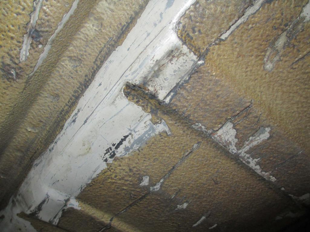

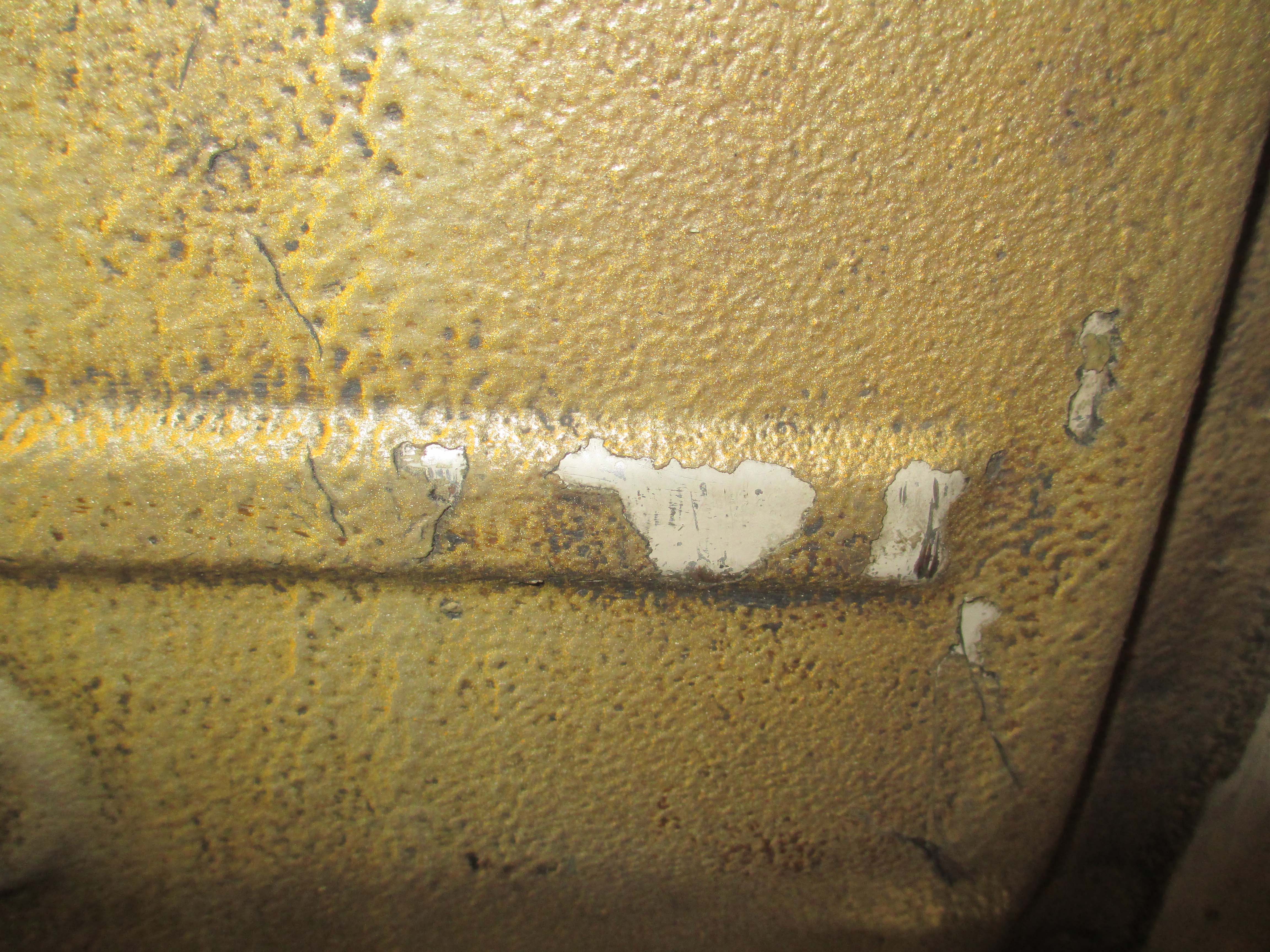

siverson   I just stumbled on these photos so I thought I...   Nov 11 2013, 07:31 PM
McMark   Yellow everywhere is right, except just a dusting....   Nov 11 2013, 07:32 PM
siverson   The yellow car is this one: http://www.ebay.com/i...   Nov 11 2013, 07:33 PM
siverson   And to add my opinion - I really don't mind th...   Nov 11 2013, 07:41 PM

Matt Romanowski   I have access to an original, one owner six. It ha...   Nov 11 2013, 09:00 PM
rick 918-S   I have access to an original, one owner six. It h...   Nov 11 2013, 10:11 PM
OmaPossu   ... I checked with the owner as to what was on it...   Nov 12 2013, 07:05 AM
Cairo94507   When Scotty shoots my Six the bottom will get full...   Nov 12 2013, 07:23 AM
puffinator   After spending an inordinate amount of time removi...   Dec 14 2013, 09:26 AM
scotty b   I think there is either some color change over tim...   Dec 14 2013, 09:35 AM
