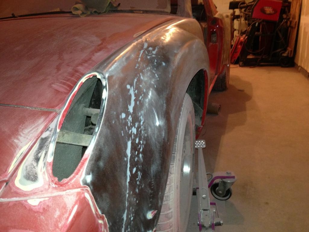

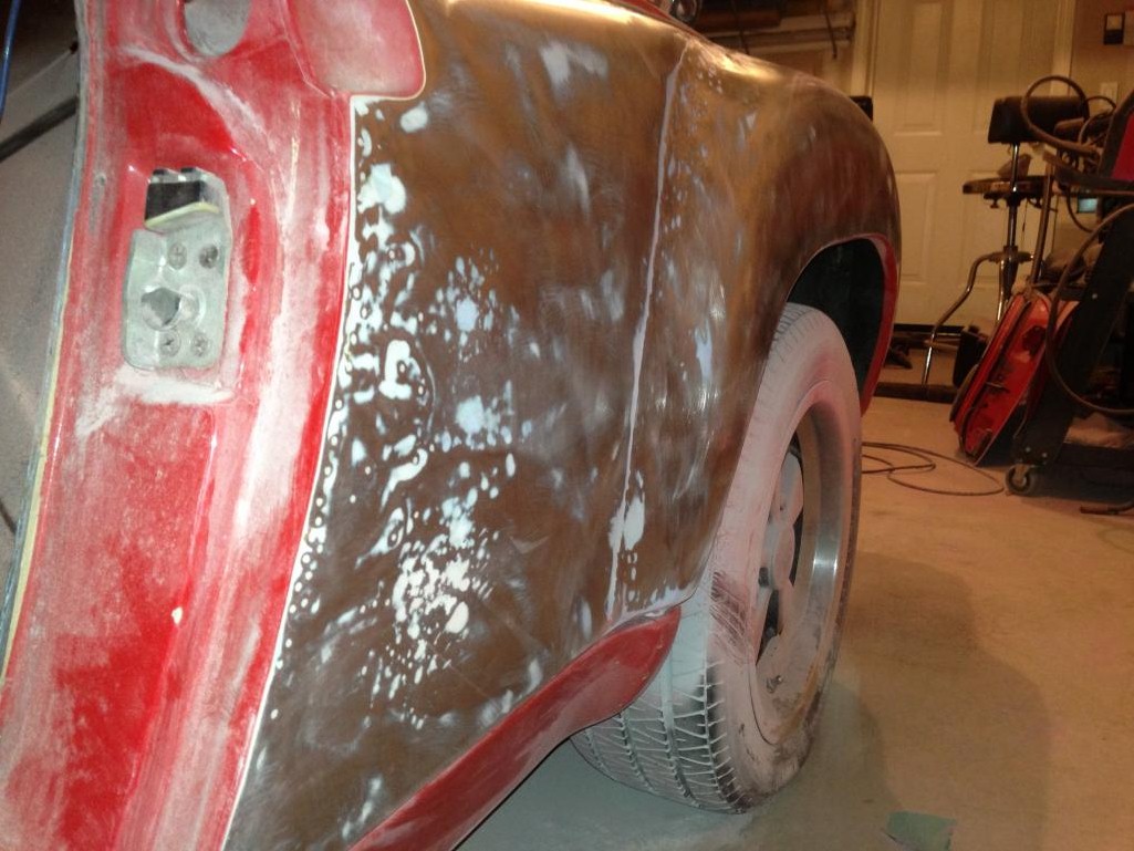

Going to widen the rear flare and repaint looks like a little more work then expected

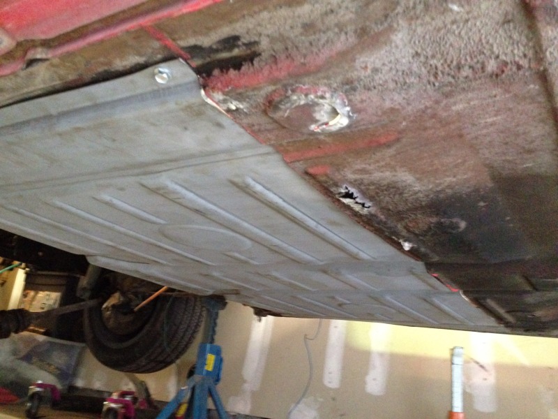

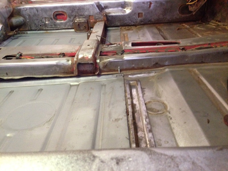

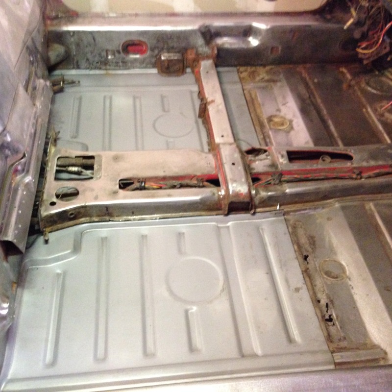

bolted up the floor then trimmed the existing piece going to patch up the bad parts of the front half.(IMG:http://www.914world.com/bbs2/uploads_offsite/img.photobucket.com-9738-1387161483.1.jpg)
(IMG:http://www.914world.com/bbs2/uploads_offsite/img.photobucket.com-9738-1387161484.2.jpg)(IMG:http://www.914world.com/bbs2/uploads_offsite/img.photobucket.com-9738-1387161484.3.jpg)

Andyrew   The flares look just sub par of a good body tech, ...   Nov 16 2012, 02:47 PM
ONTHEGRIND   Unfortunately I'm not a body guy but I do happ...   Nov 16 2012, 03:04 PM
ONTHEGRIND   Yeah I was just looking for rust gonna hammer and ...   Nov 16 2012, 03:07 PM
boogie_man   That doesn't look too bad at all, weld up and ...   Nov 16 2012, 04:09 PM
mr914   Body man is blowing up your skirt. :miles: Tryi...   Nov 16 2012, 04:36 PM
ONTHEGRIND   The body guy at my shop doesn't think it's...   Nov 16 2012, 05:05 PM
