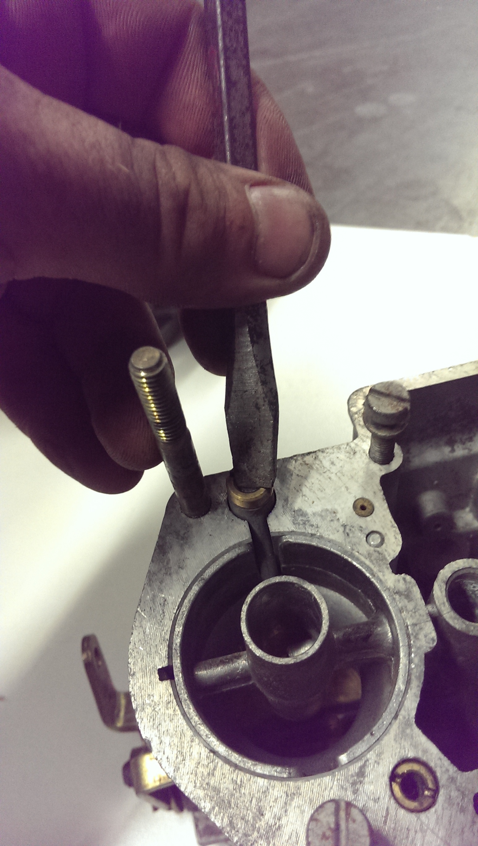

Next, move on to installing the accelerator pump jets. If you have a jet gauge (and I highly recommend you do), gently push it into the nozzle to remove any final remnants of gum or other material that may be stuck here. If you do not, and end up having a plugged pump jet after installation, you'll be forced to pull the top of the carburetor off again to clean them. As tempting as it might be, do not use a staple or other object, as the jet orifices are very small and you risk reaming them out to some unknown size.
Place one of the copper/brass sealing rings on the pump hold down screw, then the jet, then one more sealing ring. They should sandwich the jet from top and bottom. Tighten the screw down firmly but without excessive force using a wide-blade flathead screwdriver.
