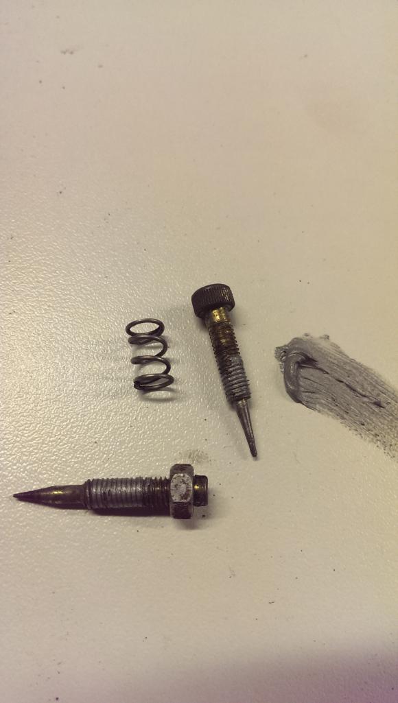

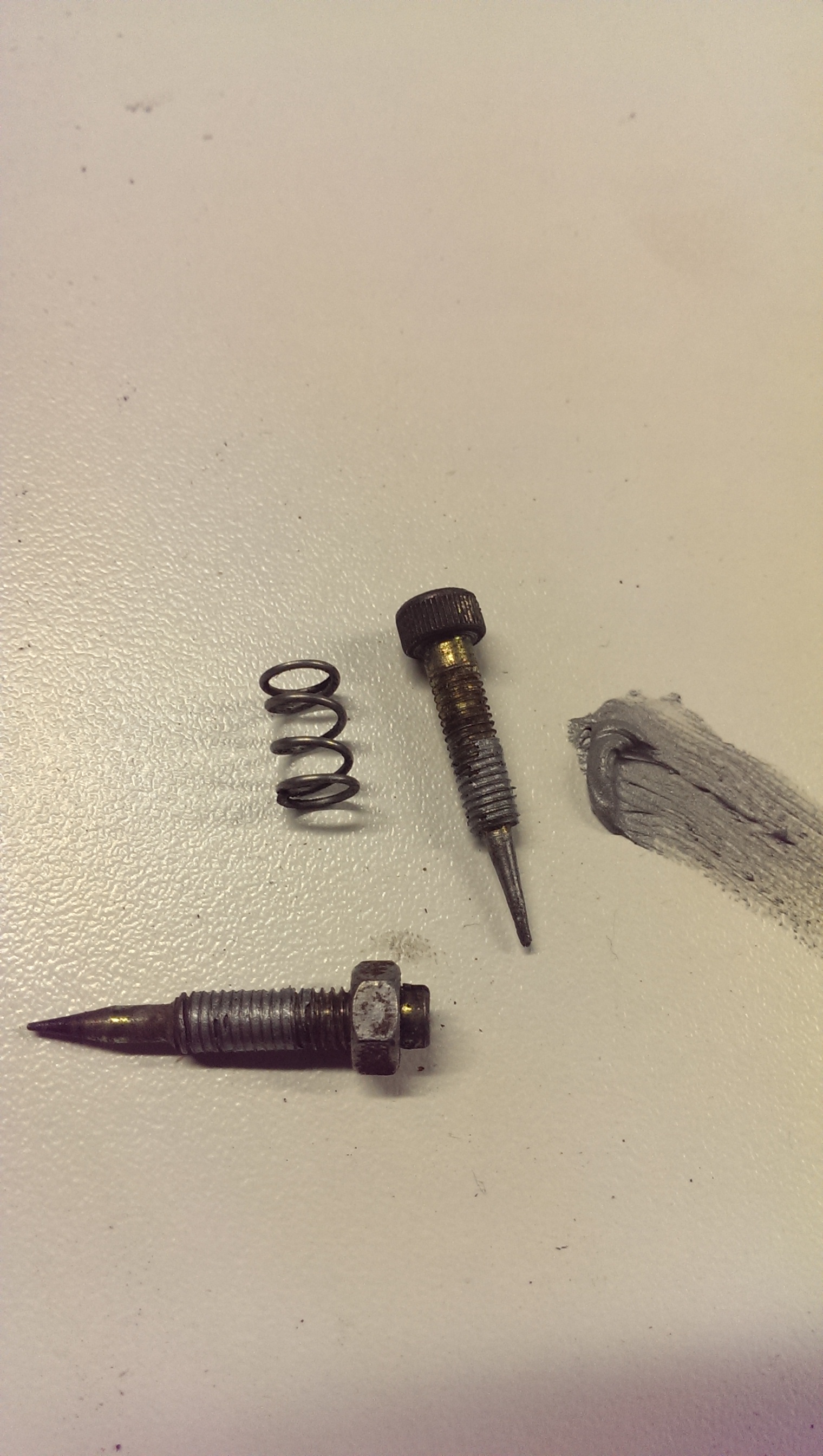

Next, begin installing the remaining hardware on the outside of the carb body. This includes the air bypass screws, idle mixture screws, vacuum port plugs (if equipped), and the idle speed screws. I recommend using a very small amount of anti-seize on them as it will make it much easier to make adjustments by hand when tuning later on. You also may wish to clean up any gum deposits on the faces of the needles with fine grit sandpaper. As mentioned by rhodyguy, don't forget the small o-rings that go under the caps for the idle mixture screws, and make darn sure you don't lose them! Also, be sure to install them on your idle jet holders as well.

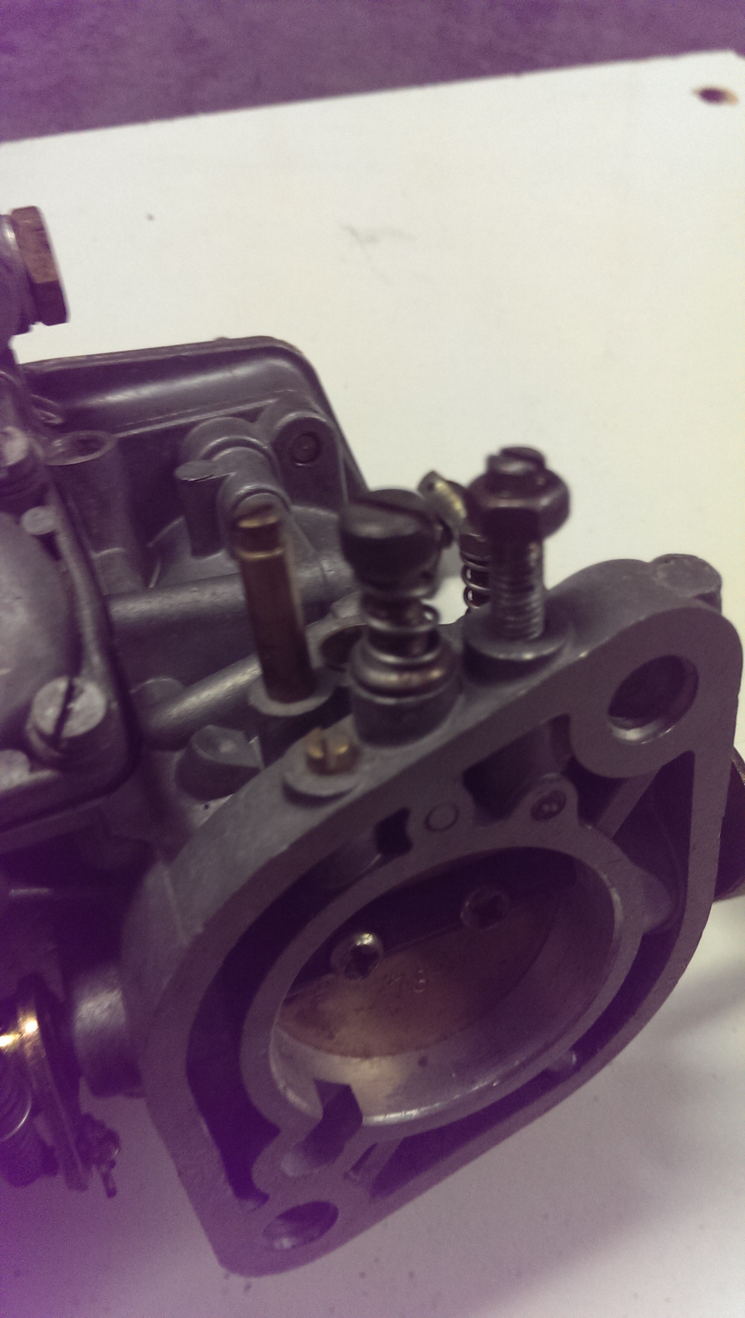

Here is how the final setup should look.

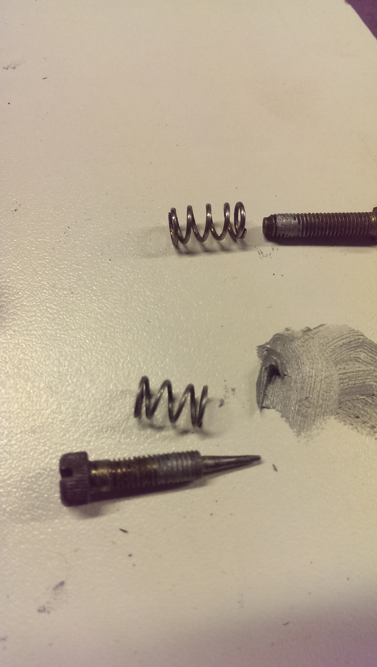

Also, note the difference in size between the idle mixture screw springs and the idle return springs. The return spring is a little beefier.
