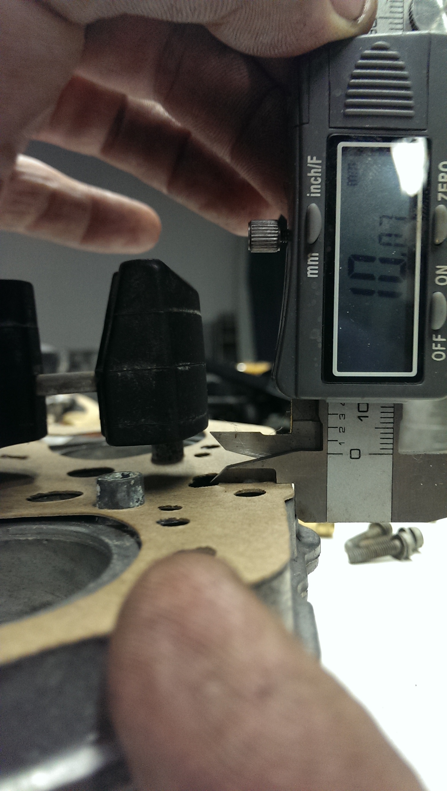

Now comes the art of setting the float level. Though the methodology is the same, there are varying opinions on what the float level should be on Webers. CB Performance lists a 14 mm gap from the gasket to the very edge of the float, but does not specify a bottom float distance. The Weber Haynes manual and other sources list a 10mm gap and a full-open gap of 32mm, which is what I use. Racers may modify the float level depending on cornering loads and other factors, but the 10/32 measurements work for me.
First, turn the carb top over so that the float is toward the ceiling. Allow the float to rest on the needle valve and do not place any pressure on it. Using a steel ruler or caliper, measure the distance from the gasket to the edge of the float. If it is not 10mm, you will need to bend the small tab that the needle valve is retained on up or down to achieve the proper distance. Don't get frustrated as it may take you several tries to get it right.
