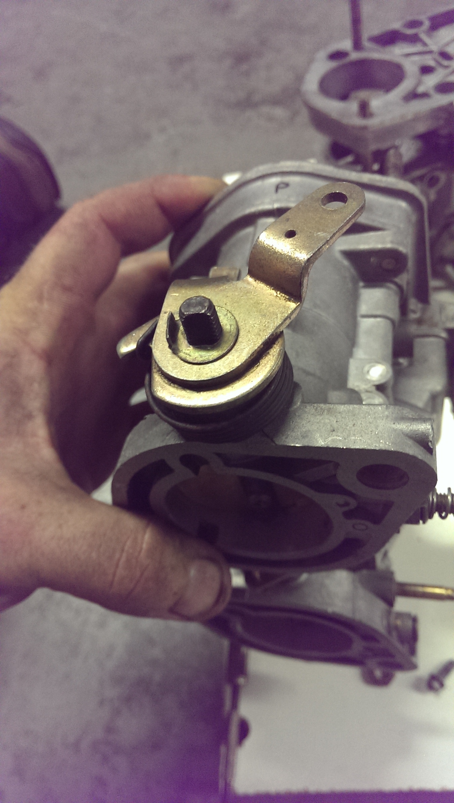

Now we need to install the linkage arms and associated hardware. Keep in mind that if you're not rebuilding the carbs that were on your car and you don't know what linkage was used previously, that the arms and spacers that you see may or may not be necessary for your setup. If you have questions, I am familiar with a few different types of linkage, so I might be able to help you determine if you have everything you need, or point you in the right direction of where to order it.

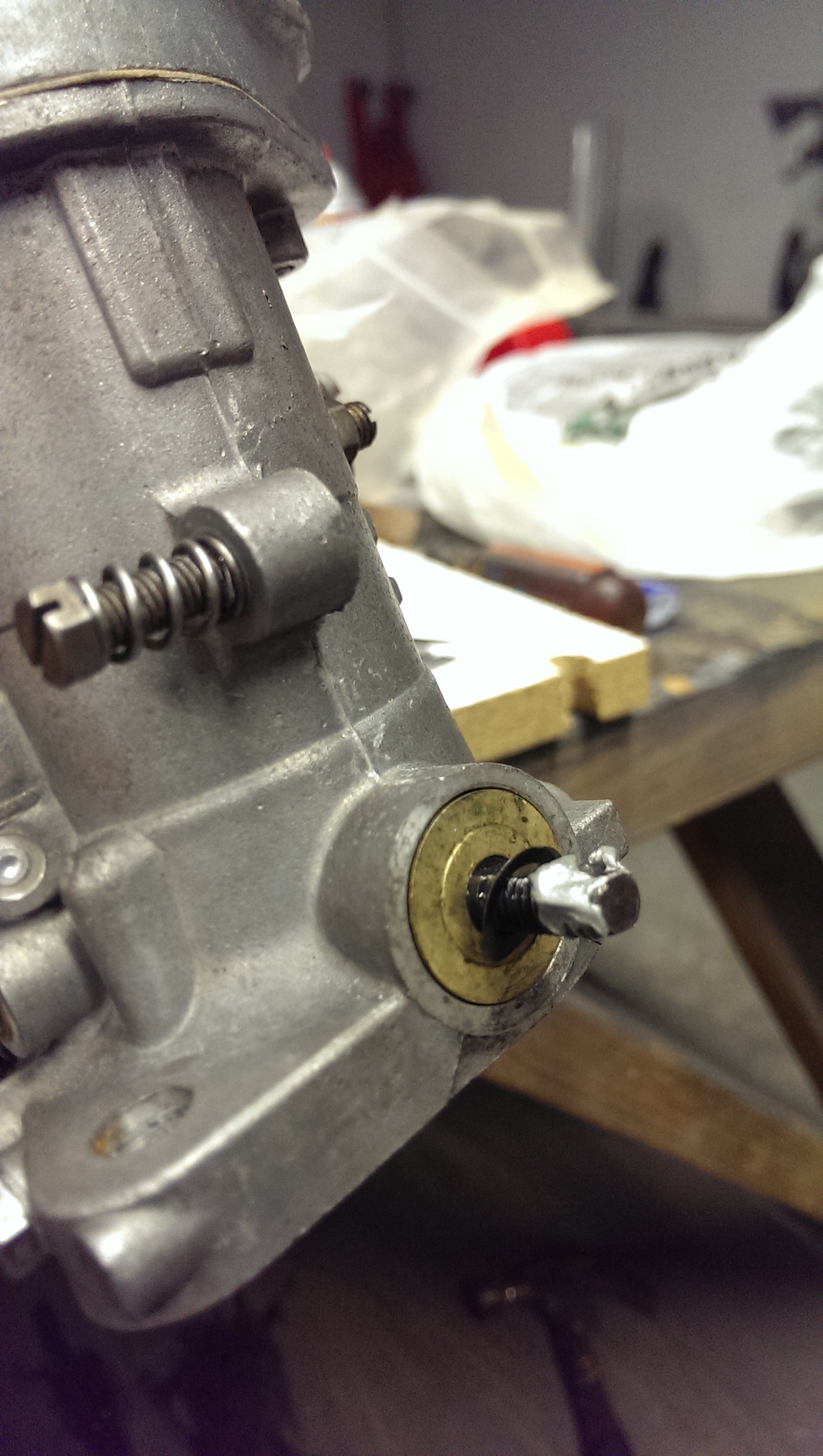

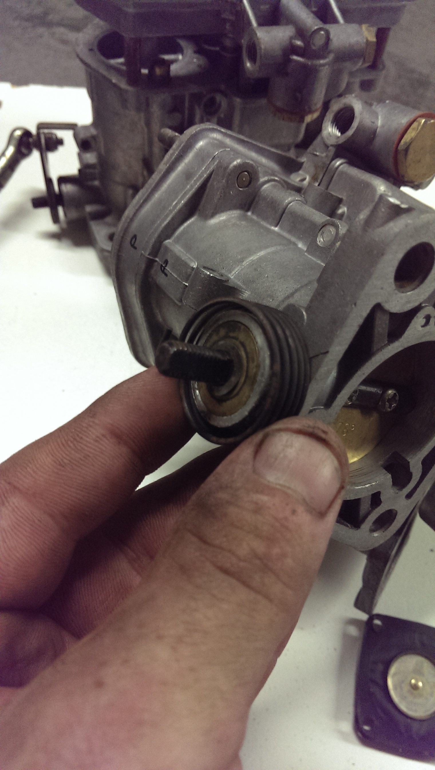

That being said, the general order should look like this. First is the round brass "Cymbal" sealing plate that keeps debris out of the bearing. On early carbs, this was essential since the bearings were not sealed, but they are still present on the later models with sealed bearings. Next is the very, very thin sealing washer seen below.
Now add the throttle return spring, if so equipped. There should only be one per carb, and the early Webers did not have them at all. Next is the appropriate throttle linkage arm or spacer, again, depending on which side of the carb you're working on.
Next install the locking tab washer and 11 mm thin nut. Do NOT forget to put some antiseize on the threads of the throttle shaft. When the nut rusts itself onto the shaft, it is notorious for taking threads with it, which will render the throttle shaft unusable and then you'll have to source a new throttle shaft, not to mention disassembling the entire carb again.
