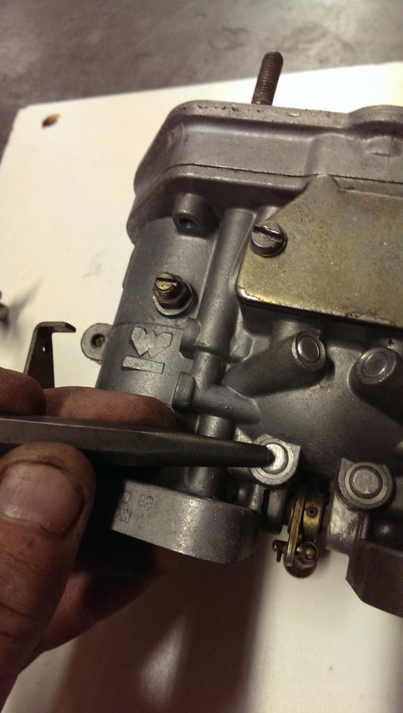

Just about done. Here is a housekeeping trick that I learned. The casting and drilling/manufacturing process of Webers means that a number of lead plugs are used to seal off several circuits of the carb. Often these plugs will leak or weep even minute amounts of gas over time. While it would be nice to replace all of these lead plugs, I don't feel that it's necessary. Instead, I take the time to use a small punch and peen these plugs in, hopefully mushrooming them out a little bit to prevent leaks. It's much easier to do this while they're out of the car rather than bending over and trying to stop them from leaking after you've got it all together.

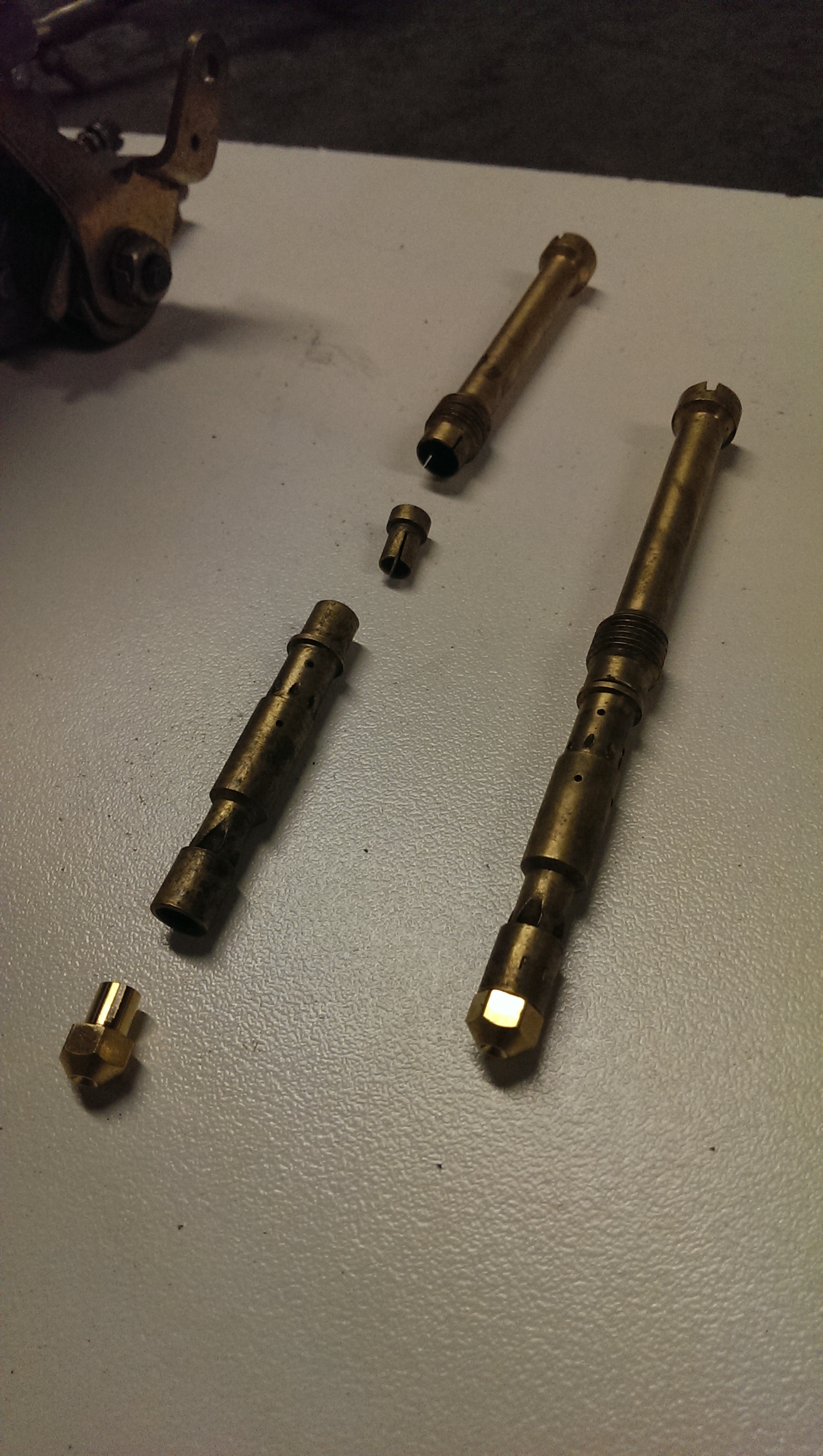

Now is a good time to reassemble the main jet stacks as well. Pretty simple, but each component must be there to serve it's function. Below is a picture of the stack, with main jet, emulsion tube, air correction jet and main jet holder. These are later style main jet holders which "snorkel" above the top of the carb body, in comparison to the lower, early jet holders. Note: if you want to see a cool trick, check out Van Svenson's video on Youtube where he explains how to ensure that the main jets are seating properly. Once they're complete, go ahead and install them.

ThePaintedMan   [I had one of these plugs completely shoot out du...   Dec 17 2013, 09:49 PM

rhodyguy   lost one of those plugs once while driving. engine...   Dec 28 2013, 09:10 AM
