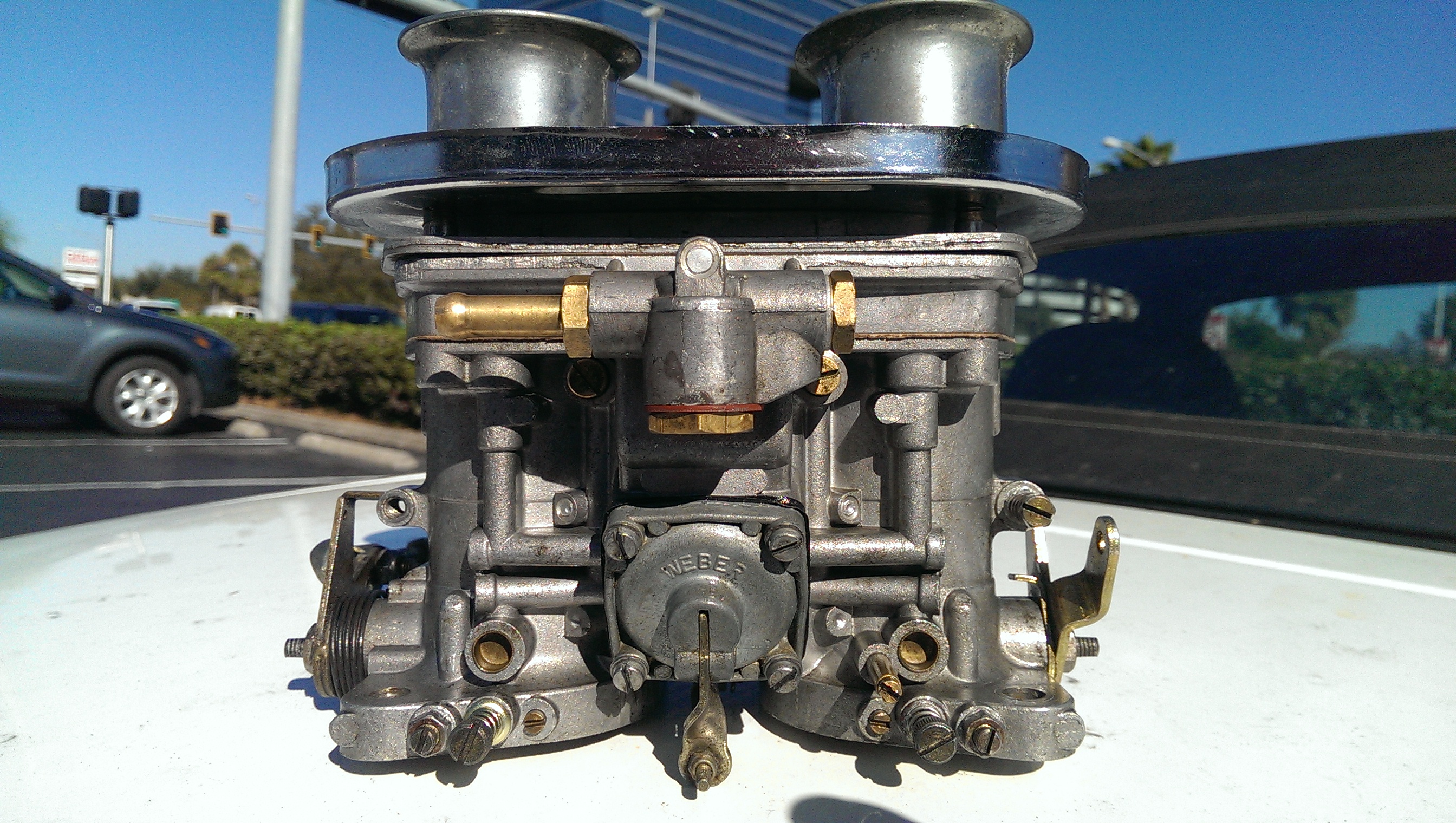

Below is a picture of an early and late set of Weber 40 IDFs.
Some of the characteristics of EARLY versions are:
-Short emulsion tube holders
-Short throttle shafts with little overhang outside of the carb body
-Non-sealed, ball-in-cage style throttle shaft bearings
-Cam-actuated, non-adjustable accelerator pump assembly
-No ports for "ported" vacuum (still has 2 "manifold" vacuum ports)
-76 degree bevel throttle plates (this may or may not hold true for every set of early carbs)
-No throttle return springs installed from factory (thanks Kevin for clarification)
-Most (all?) were made in Italy and are stamped as such
Later style Weber 40 IDFs (Weber 40 XEs) are usually characterized by:
-Taller emulsion tube holders which extend above the carb top
-Longer throttle shafts
-Sealed black throttle shaft bearings
-Adjustable, spring cushioned accelerator pump assembly
-One pre-drilled ported vacuum port in addition to two threaded manifold vacuum ports
-78 degree bevel throttle plates
-Factory installed throttle return springs
-Made in Spain, but potentially also Italy and Brazil
Please note that most of these instructions to follow are also true for 44s and 48s as well. The main difference being the way that the secondary venturis are designed.
