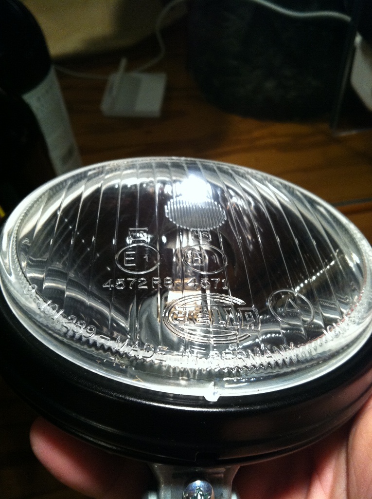

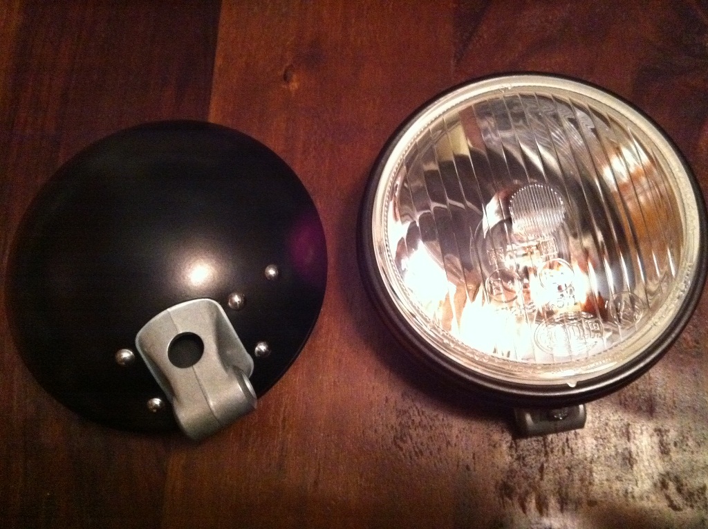

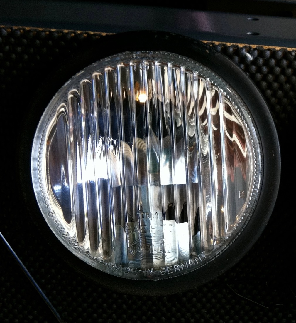

I have a NOS set here's pictures to show the difference, also, while the US fogs were incandescent the Euro driving lights were H3's:
US Fogs-note the fluting on the lense obscures the bulb and the reflector is positioned between the bulb and the lens:
Euro Driving lights-note the lack of fluting and there is only a very small reflector in front of the H3 bulb:
