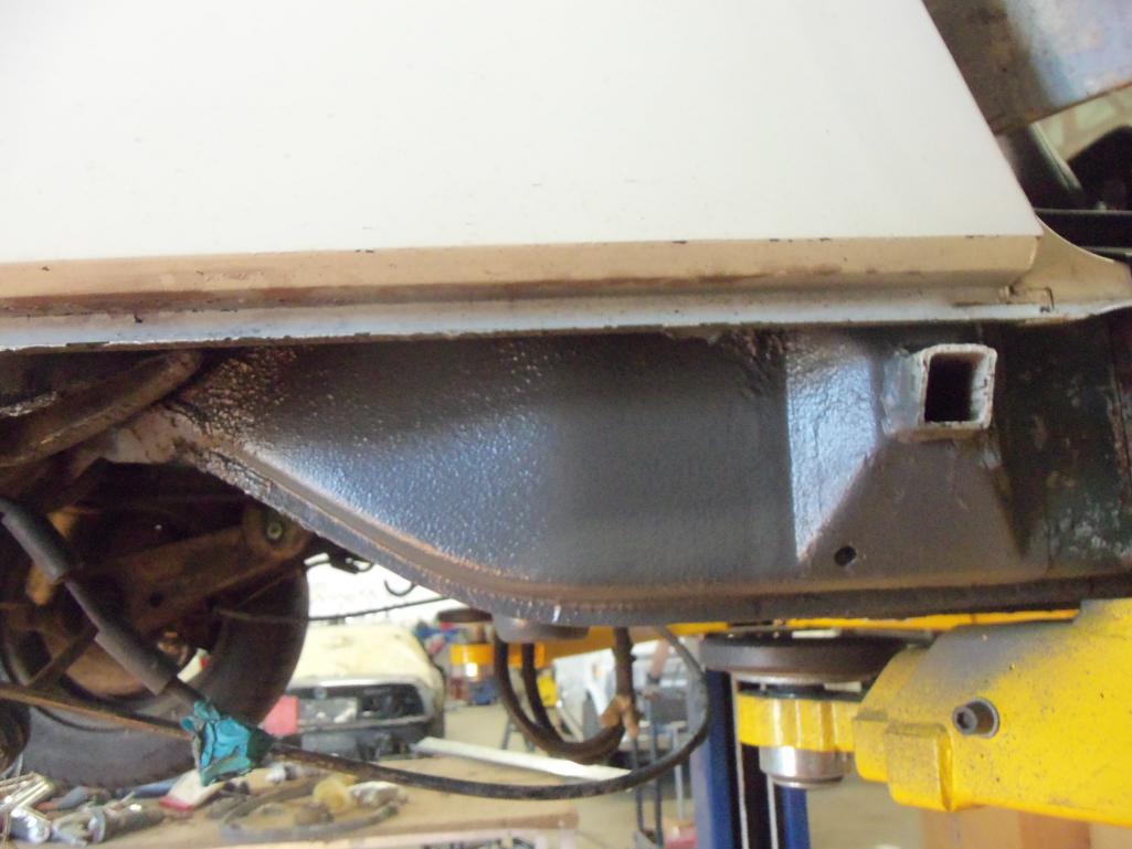

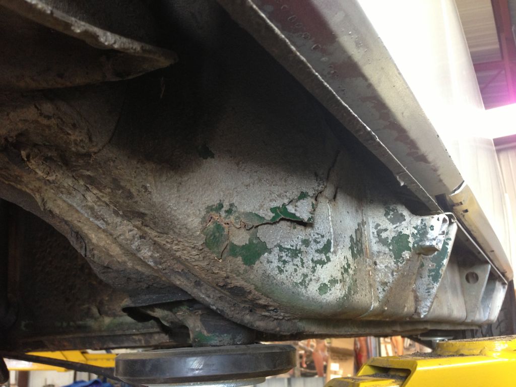

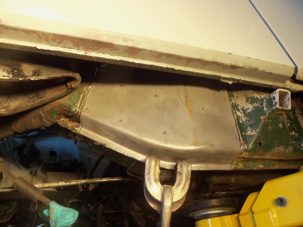

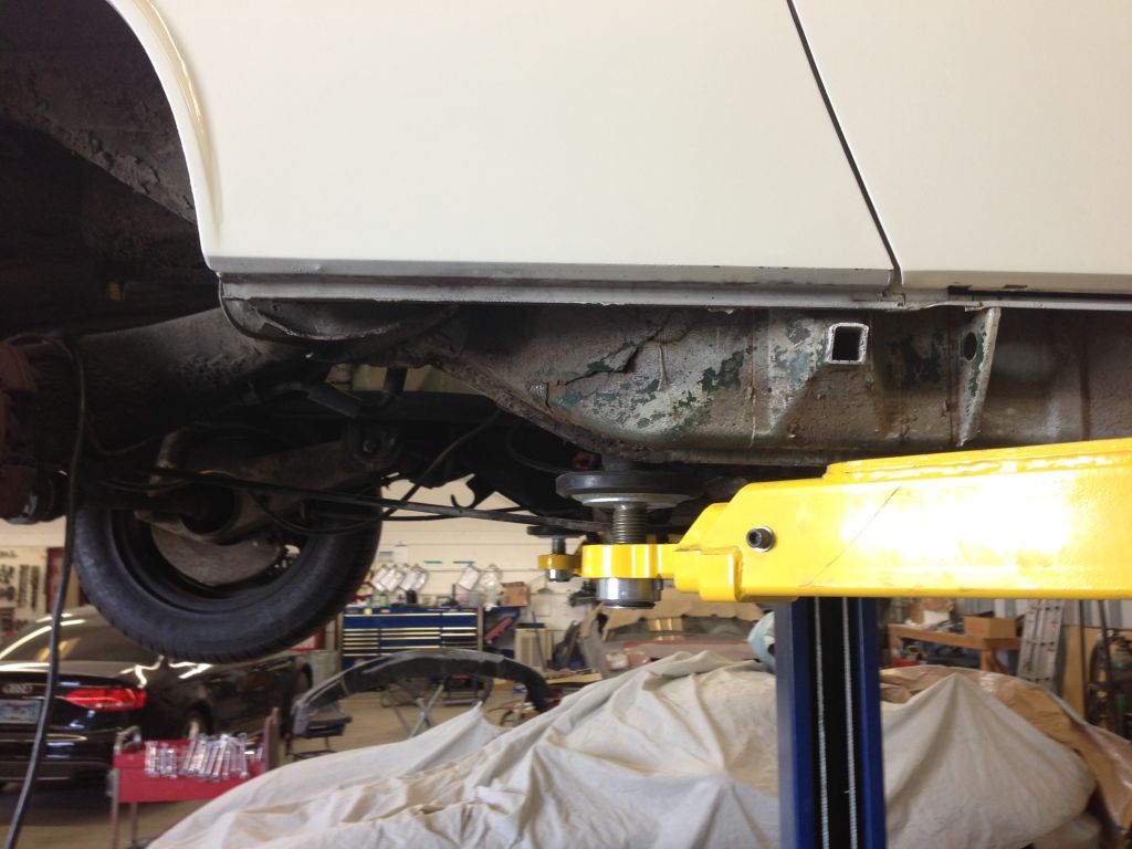

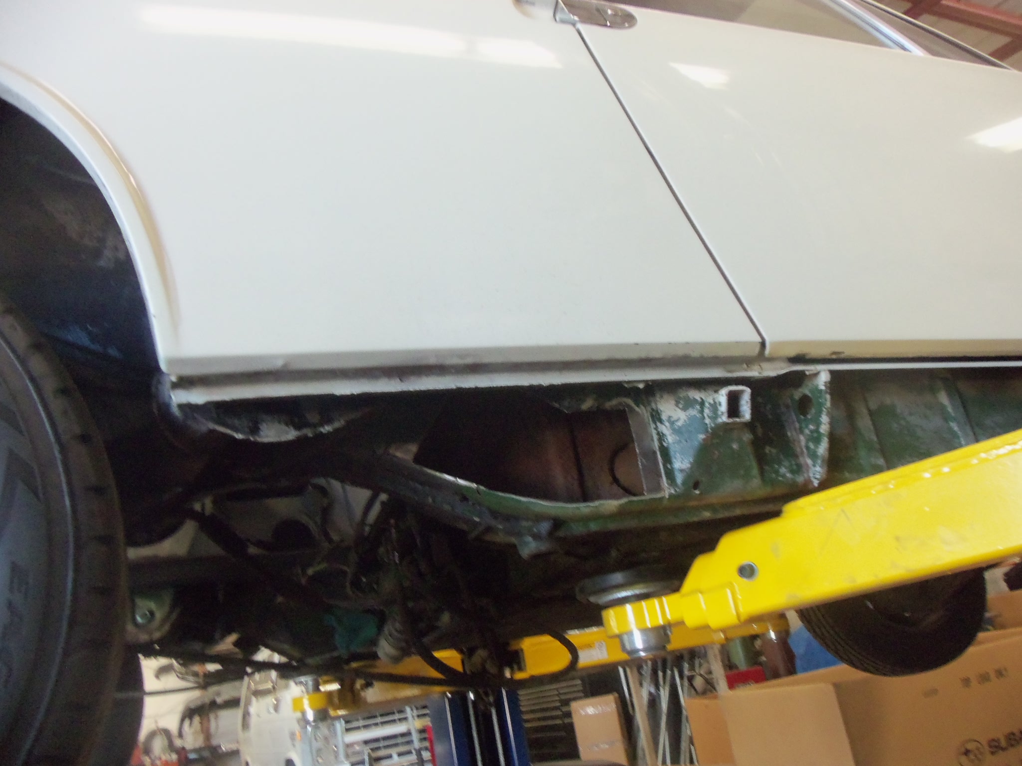

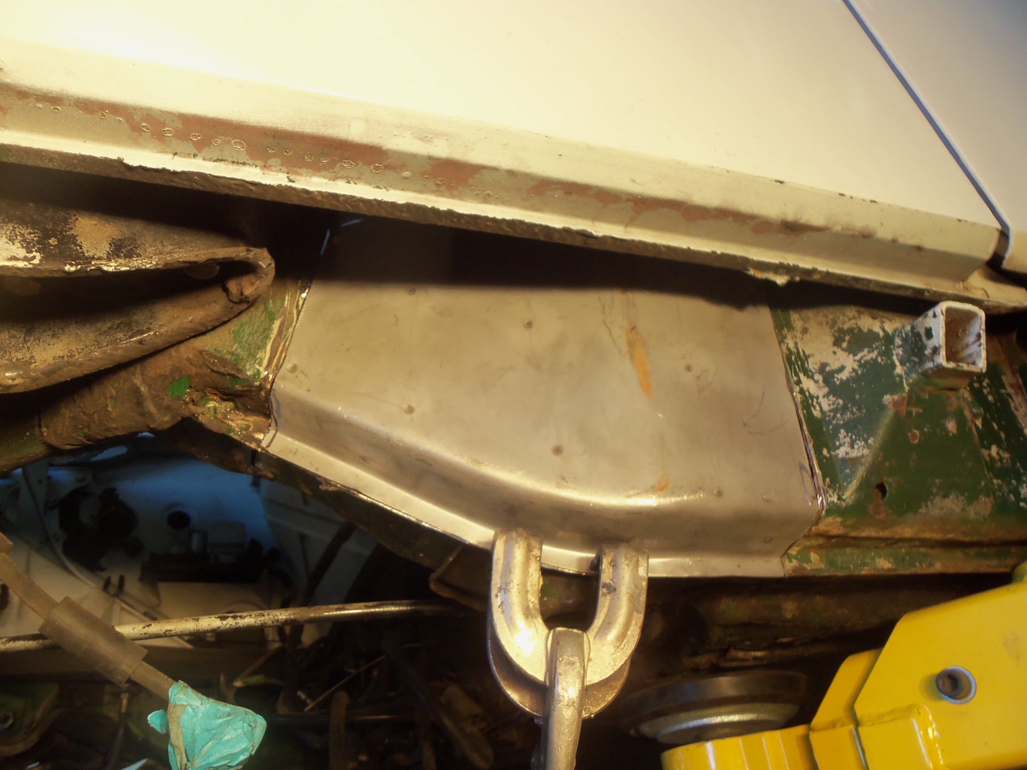

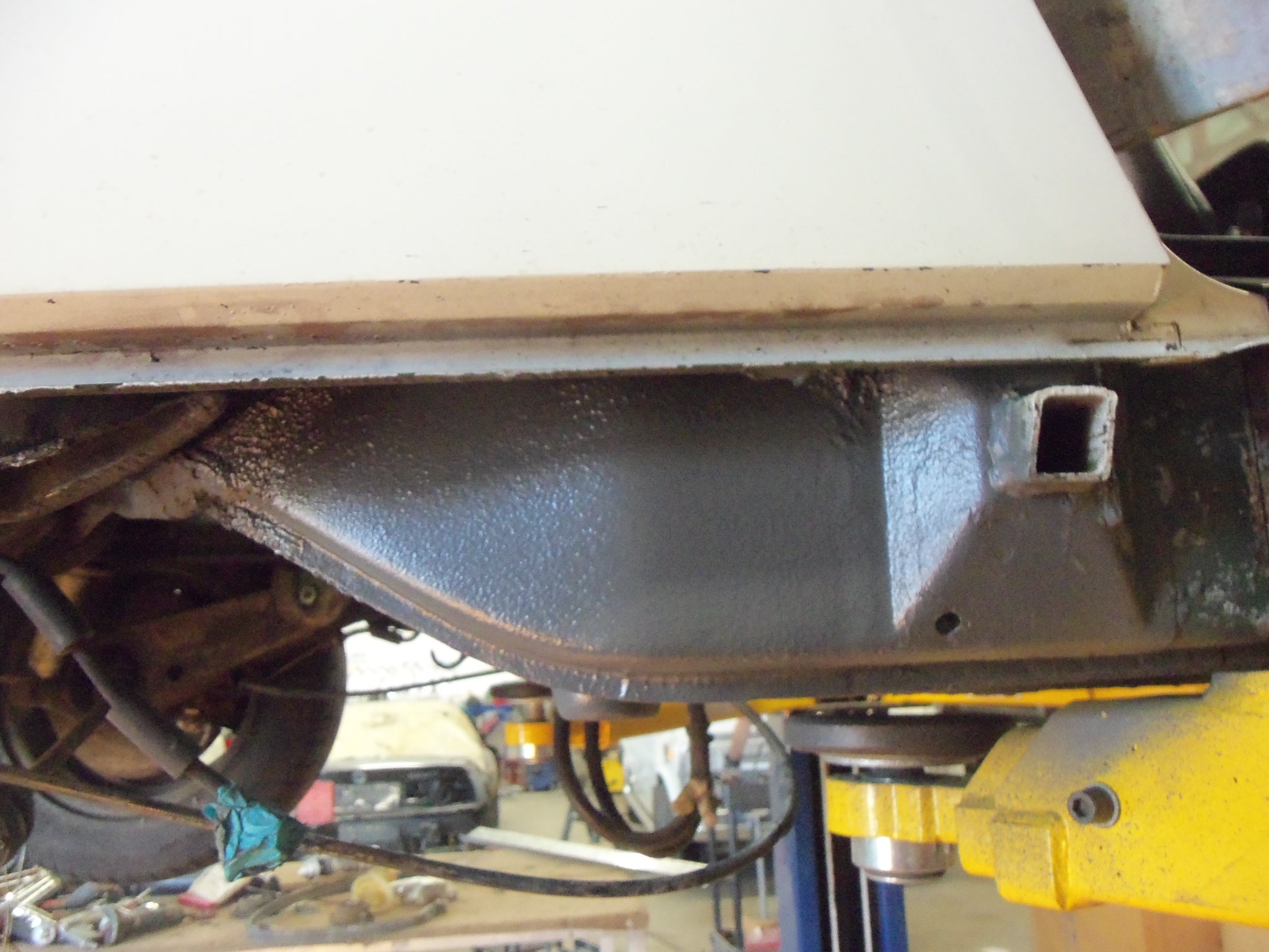

siverson   I got these photos from the body shop today... Th...   Dec 19 2013, 11:47 PM
siverson   And the battery box area repair. Anything the exp...   Dec 19 2013, 11:58 PM
siverson   And the repair...   Dec 20 2013, 12:00 AM
siverson   914   Dec 20 2013, 12:01 AM
siverson   914   Dec 20 2013, 12:03 AM
