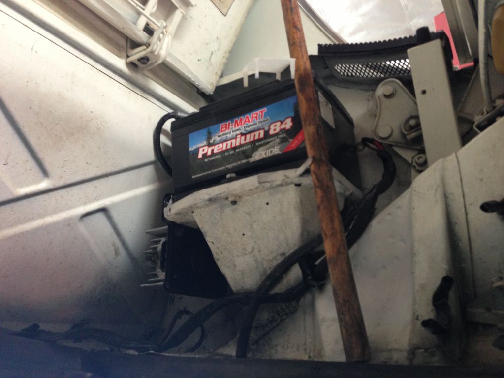

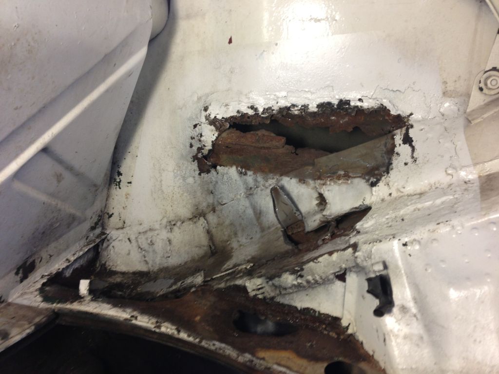

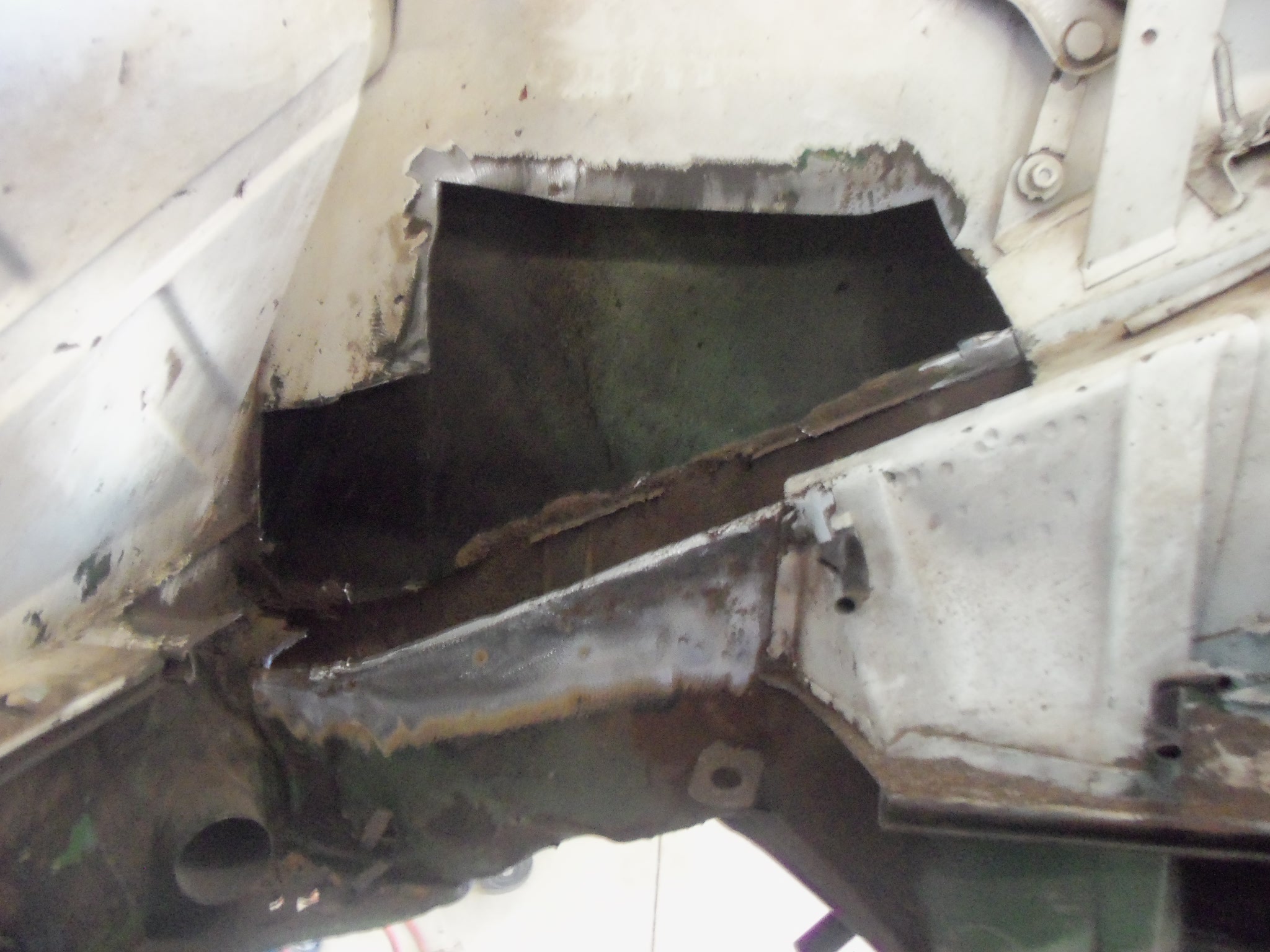

Anything the experts out there would have done differently? I'm considering having this shop do the exterior as well...
-Steve
This doesn't look so bad...
Argh, worse than I thought...
Holy crap!!!
