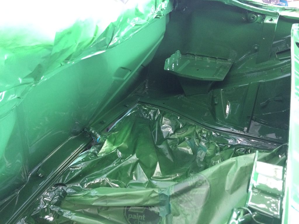

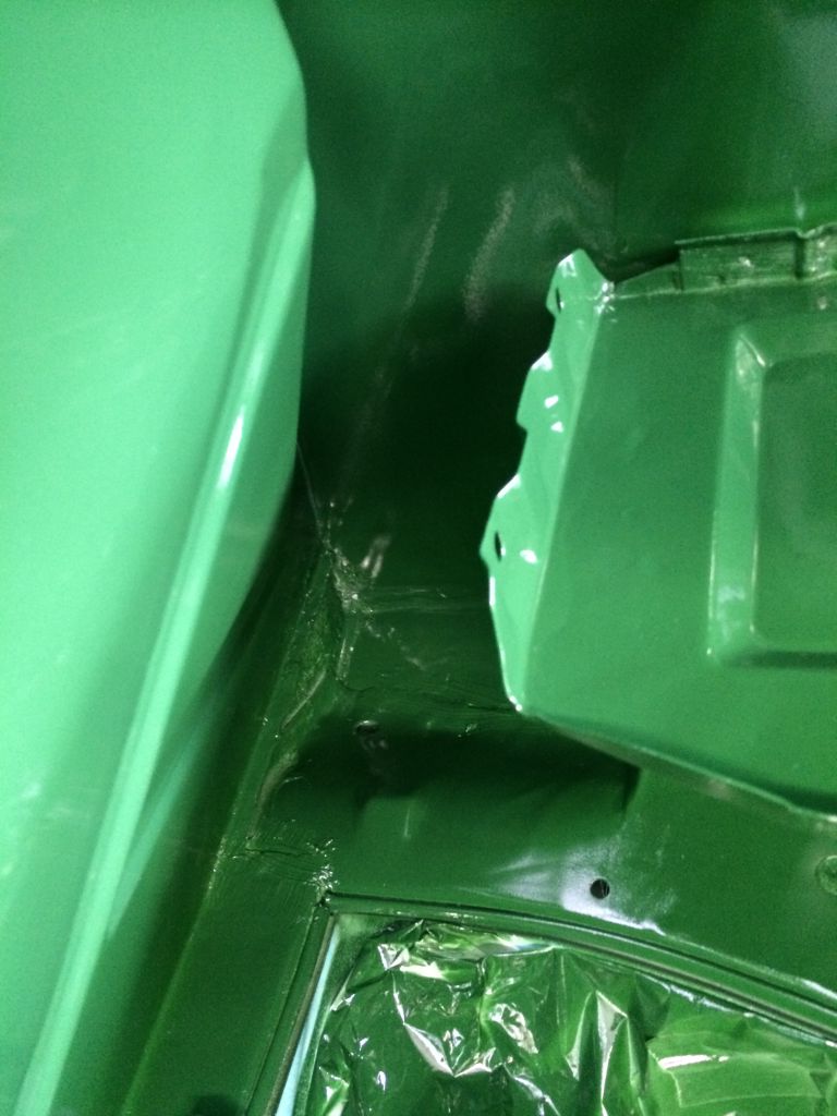

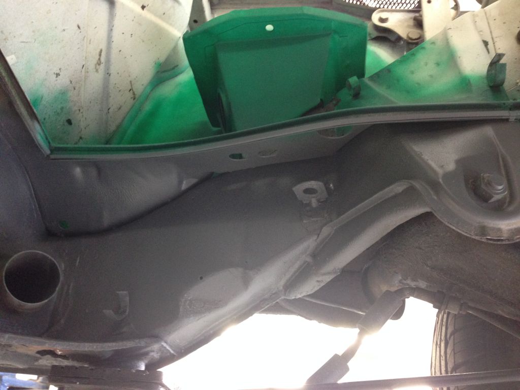

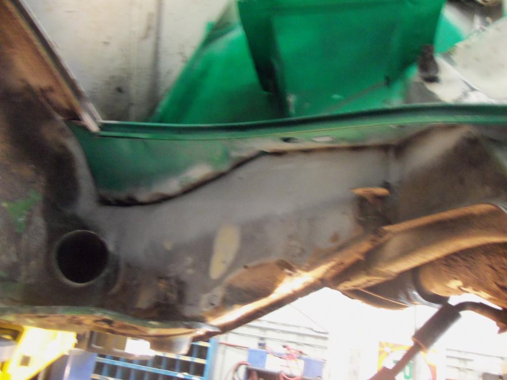

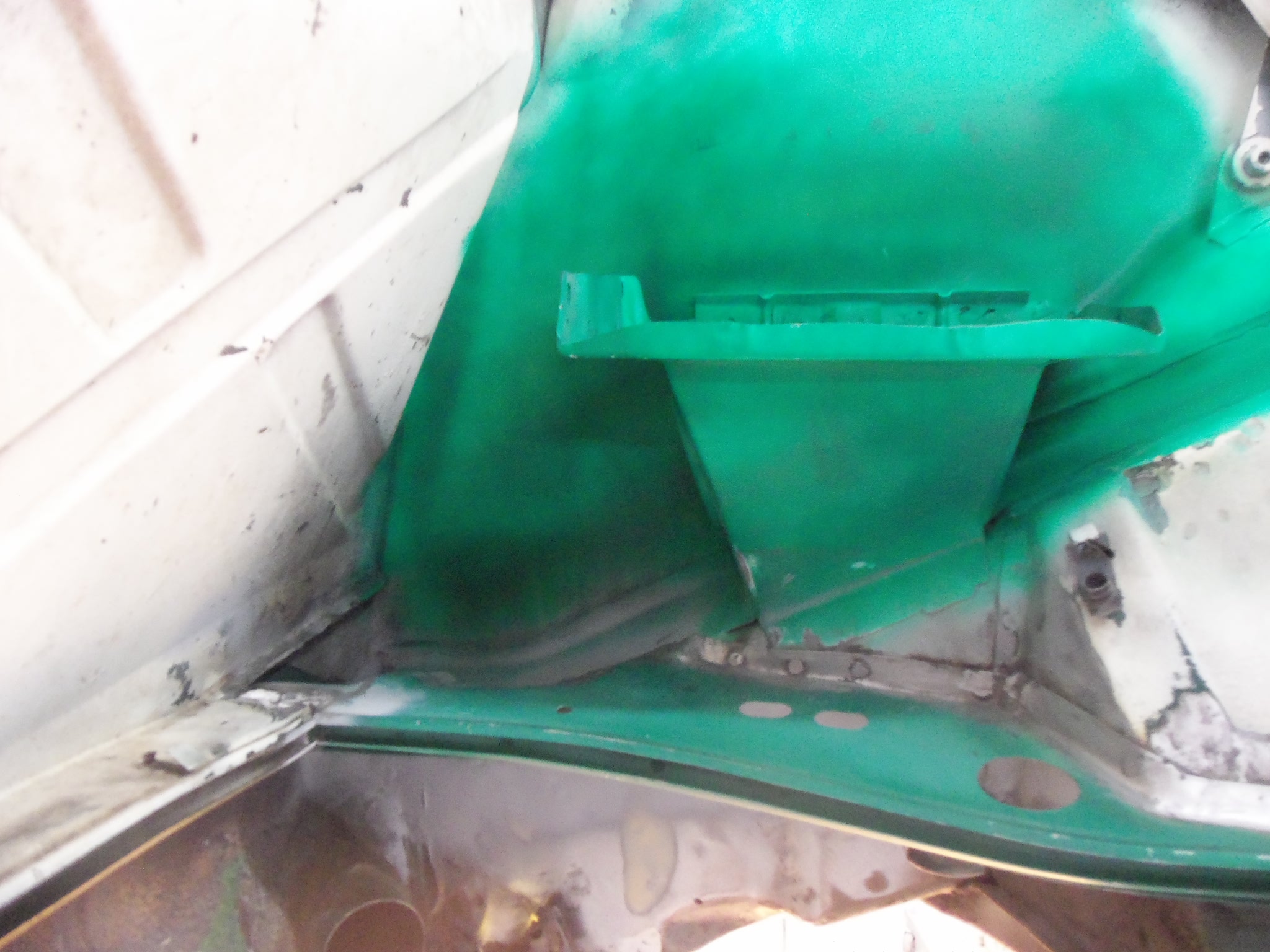

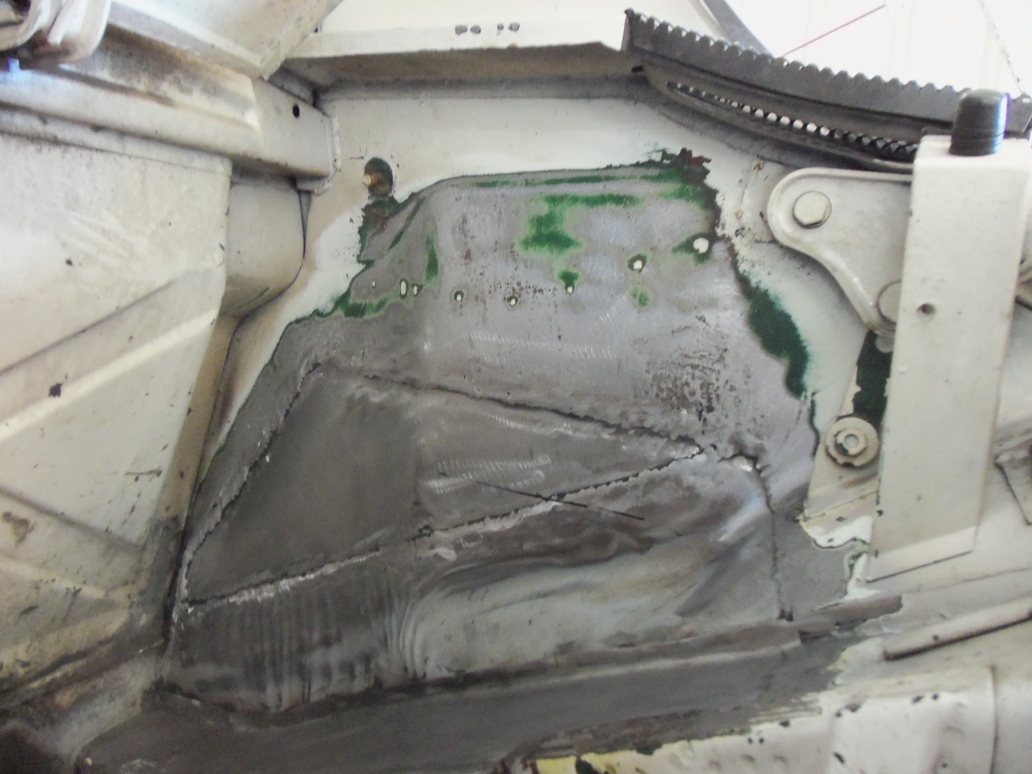

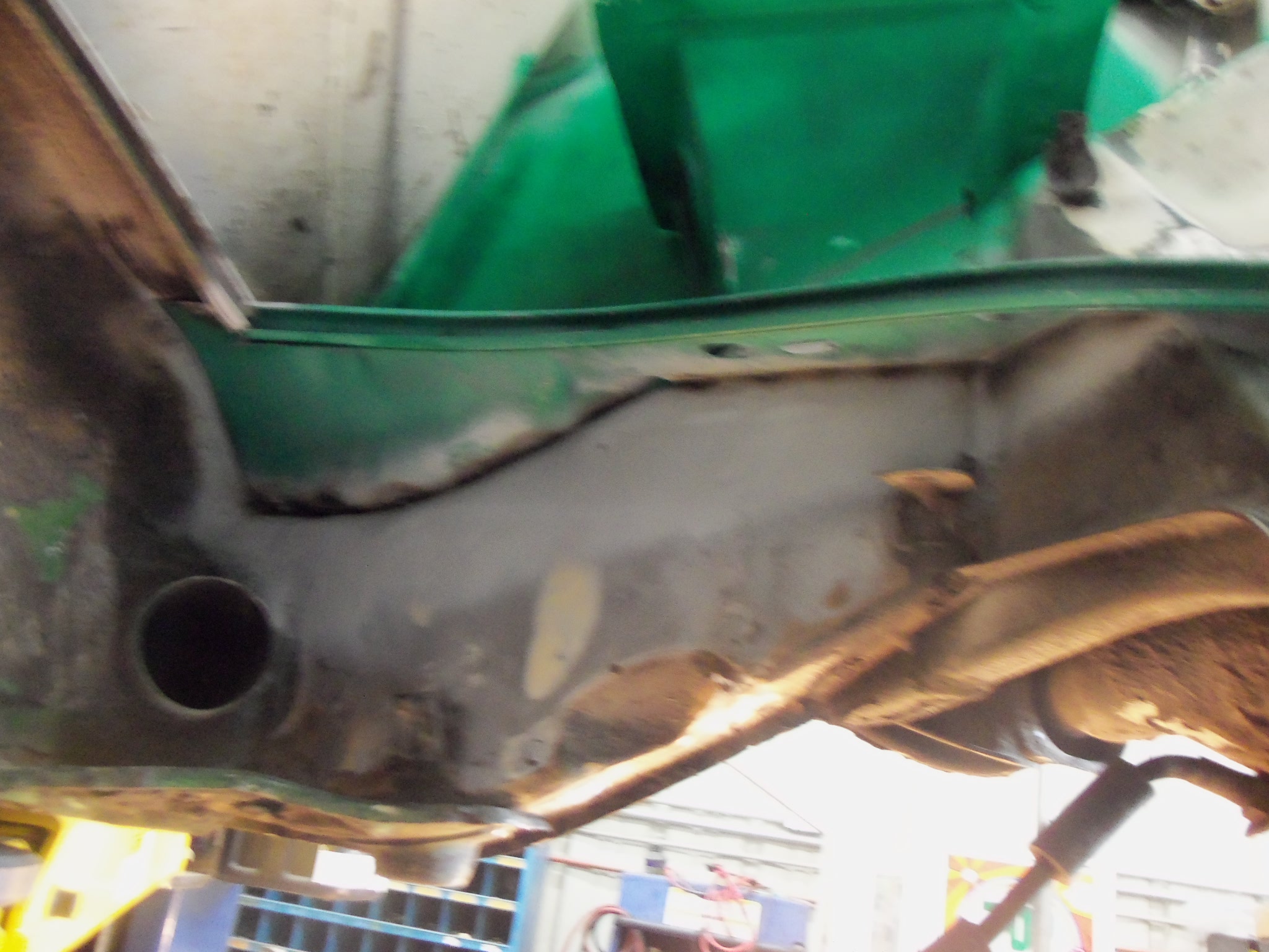

siverson   I got these photos from the body shop today... Th...   Dec 19 2013, 11:47 PM

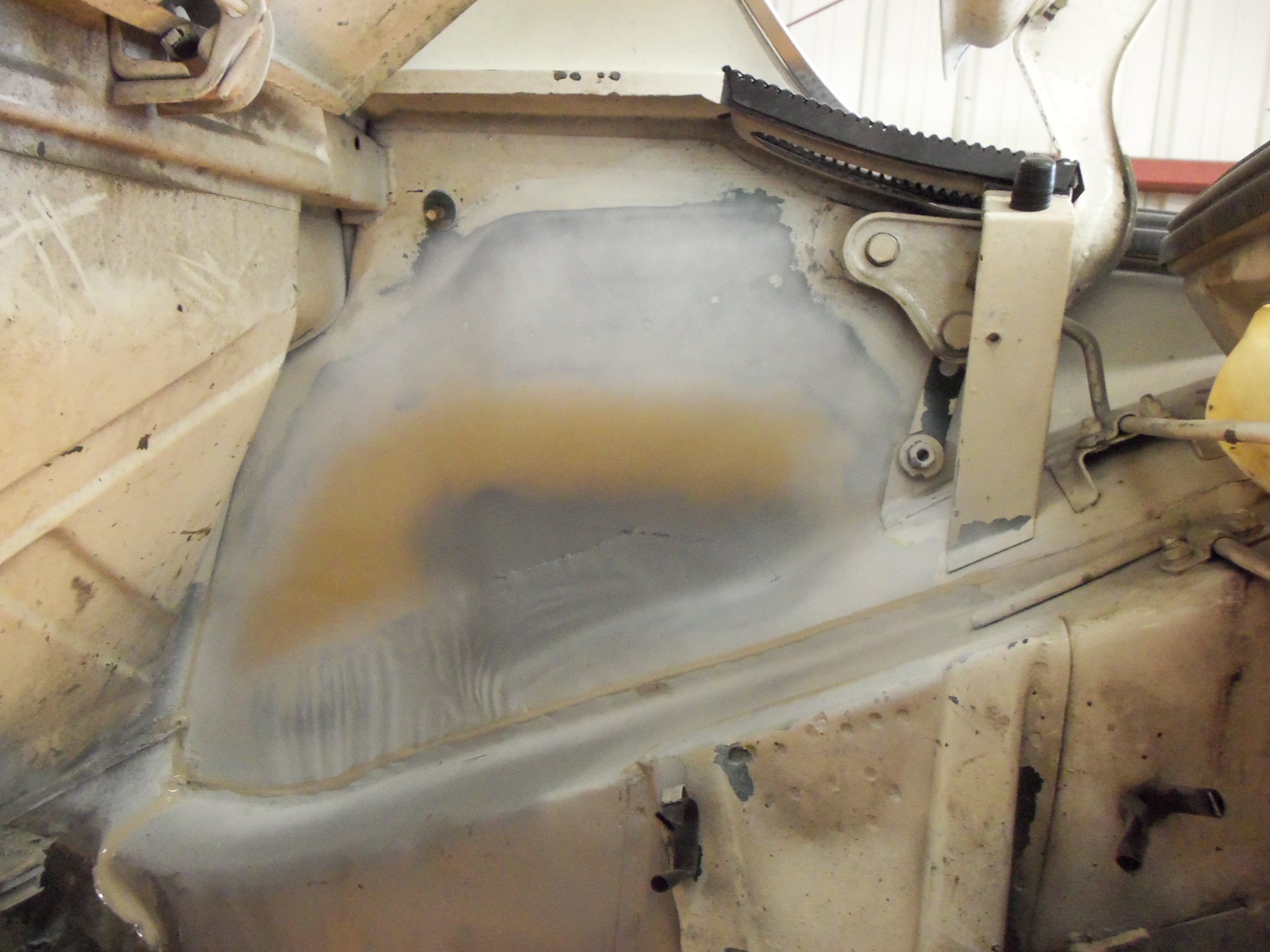

siverson   And the battery box area repair. Anything the exp...   Dec 19 2013, 11:58 PM
siverson   And the repair...   Dec 20 2013, 12:00 AM
siverson   914   Dec 20 2013, 12:01 AM
siverson   914   Dec 20 2013, 12:03 AM
rick 918-S   Nice! There moving right along! :sawzall: ...   Dec 20 2013, 06:36 AM
JmuRiz   I think it's safe to say they are all rusted o...   Dec 20 2013, 08:31 AM
