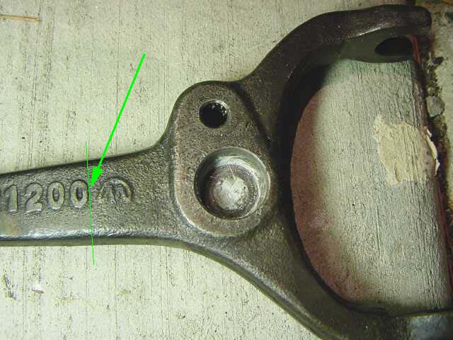

Hey guys, I need some help with a release fork/pivot shim issue I have run into.
I am working on reinstalling my transmission after my lost driveshaft incident.
I have a new clutch release fork that I installed, and I noticed that when I stuck the transmission back on the engine, the fork doesn't have more than a few mm of free play before it hits the transmission housing. So I think hmmm and I pull it back apart.
Then I think back to the last time I did this, I put in a new cup in the old throwout arm. At that time I noticed the ball cup stuck way out of the fork and I had to actually trim it down to fit. I thought it was weird but blamed Brad on giving me crap parts (just kidding Brad). I even took a picture, shown below.
post Jul 30 2004, 03:18 PM
Resident German
Posts: 42,473
Joined: 21-January 03
From: Oakland, Kalifornia
Member No.: 179
bend here, towards the engine (away from the tranny) ...

jkeyzer   It wiggles a lot. At least 15-20 mm. That is the...   Jul 30 2004, 03:18 PM
SirAndy   bend here, towards the engine (away from the trann...   Jul 30 2004, 03:18 PM
SirAndy   <...   Jul 30 2004, 03:20 PM
jkeyzer   are you serious? Andy, you're scaring me. An...   Jul 30 2004, 03:26 PM
bondo   Ahh, ok, I misunderstood the problem. Bend that su...   Jul 30 2004, 03:30 PM
SirAndy   <...   Jul 30 2004, 03:31 PM
bondo   <...   Jul 30 2004, 03:33 PM
jkeyzer   Ok. So that solves the problem of the fork hittin...   Jul 30 2004, 03:37 PM
SirAndy   <...   Jul 30 2004, 03:40 PM
jkeyzer   Andy - I bent the fork just like you said and it ...   Aug 12 2004, 11:33 PM
SirAndy   <...   Aug 13 2004, 12:30 PM
MarkV   How much did you have to bend it? Do you have a ph...   Aug 13 2004, 01:56 PM
jkeyzer   Well, I would have a picture, but someone STOLE my...   Aug 13 2004, 02:13 PM
