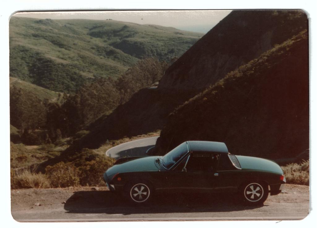

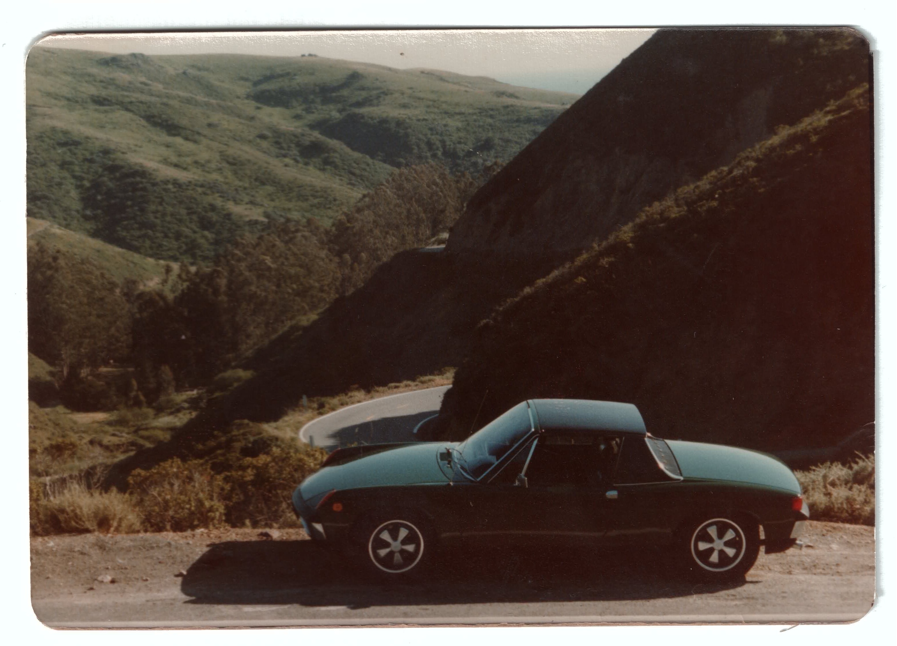

siverson
post Dec 22 2013, 01:04 PM
Posts: 2,464
Joined: 5-May 03
From: San Diego, CA
Member No.: 654
From May 1977 when he was still Irish Green... But has the 15" Fuchs that it still has today - originally had steelies.
-Steve

siverson   From May 1977 when he was still Irish Green... But...   Dec 22 2013, 01:04 PM
