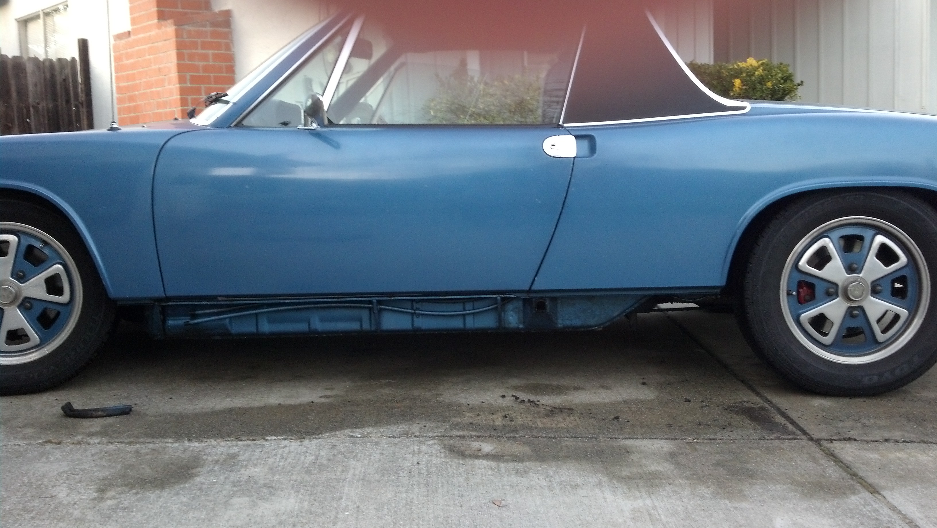

Check your longs!! Mine had some piles of dirt come out (not necessarily picture below) but not that much. There wise a nice clod of dirt compacted around the jack point on the passenger side.
My car is, so fortunately, looking pretty good. I have rust in the hell hole. My firewall and floorboards look great. I am sure there is rust back in behind that long area though.
First is drivers side:

Doesn't look bad at all.
Maybe wire-brush the surface rust and hit it with some rust mort (or a similar product)?
I'm more concerned with what the insides of my longs look like, since I did have a hell hole issue/repair.
I need to determine the best location(s) to insert the inspection camera. I don't think the OEM drain slots are large enough to accommodate the camera head. I'm leery of pulling those rubber plugs from the inside (passenger compartment) for fear they will either break, or have a hard time reinstalling them (IMG:style_emoticons/default/confused24.gif)
Are they still available new? ... Bueller?, anyone?

boxsterfan   Hmmmm......that seems like a good idea to drill so...   Jan 1 2014, 09:12 PM
gifted914   Hmmmm......that seems like a good idea to drill s...   Jan 2 2014, 12:49 AM
euro911   I'm going to insert an inspection camera in th...   Jan 2 2014, 02:13 AM
cary   The rocker panel has drains pressed in it already ...   Jan 2 2014, 08:05 AM
ThePaintedMan   :agree: When I did my long repair, I made sure t...   Jan 2 2014, 08:15 AM
rhodyguy   with that amount pictured i think you're in pr...   Jan 2 2014, 09:14 AM
boxsterfan   Thanks for all of the replies. I am going to clean...   Jan 2 2014, 11:05 AM
gifted914   Thanks for all of the replies. I am going to clea...   Jan 2 2014, 01:40 PM
boxsterfan   Thanks for the all the replies. Who sells the Roc...   Jan 2 2014, 02:00 PM
euro911   Once you spray an 'encapsulator', why woul...   Jan 2 2014, 03:02 PM
boxsterfan   Once you spray an 'encapsulator', why wou...   Jan 2 2014, 03:54 PM
nsyr   After the rust is treated, flood the inside of the...   Jan 2 2014, 05:06 PM
cary   Here's a picture of the rocker laying on the b...   Jan 2 2014, 10:16 PM
boxsterfan   So I was able to finish cleaning up the longs toda...   Jan 4 2014, 10:21 PM
euro911   Doesn't look bad at all. Maybe wire-brush the...   Jan 4 2014, 11:14 PM
boxsterfan   Yeah, those rubber plugs would be good to know if ...   Jan 5 2014, 12:49 AM
boxstr   If you look inside the engine compartment back up...   Jan 5 2014, 03:17 PM
boxstr   If you look inside the engine compartment back up...   Jan 5 2014, 03:44 PM
euro911   Thanks, Craig ... I'll check it out and see if...   Jan 5 2014, 05:08 PM
