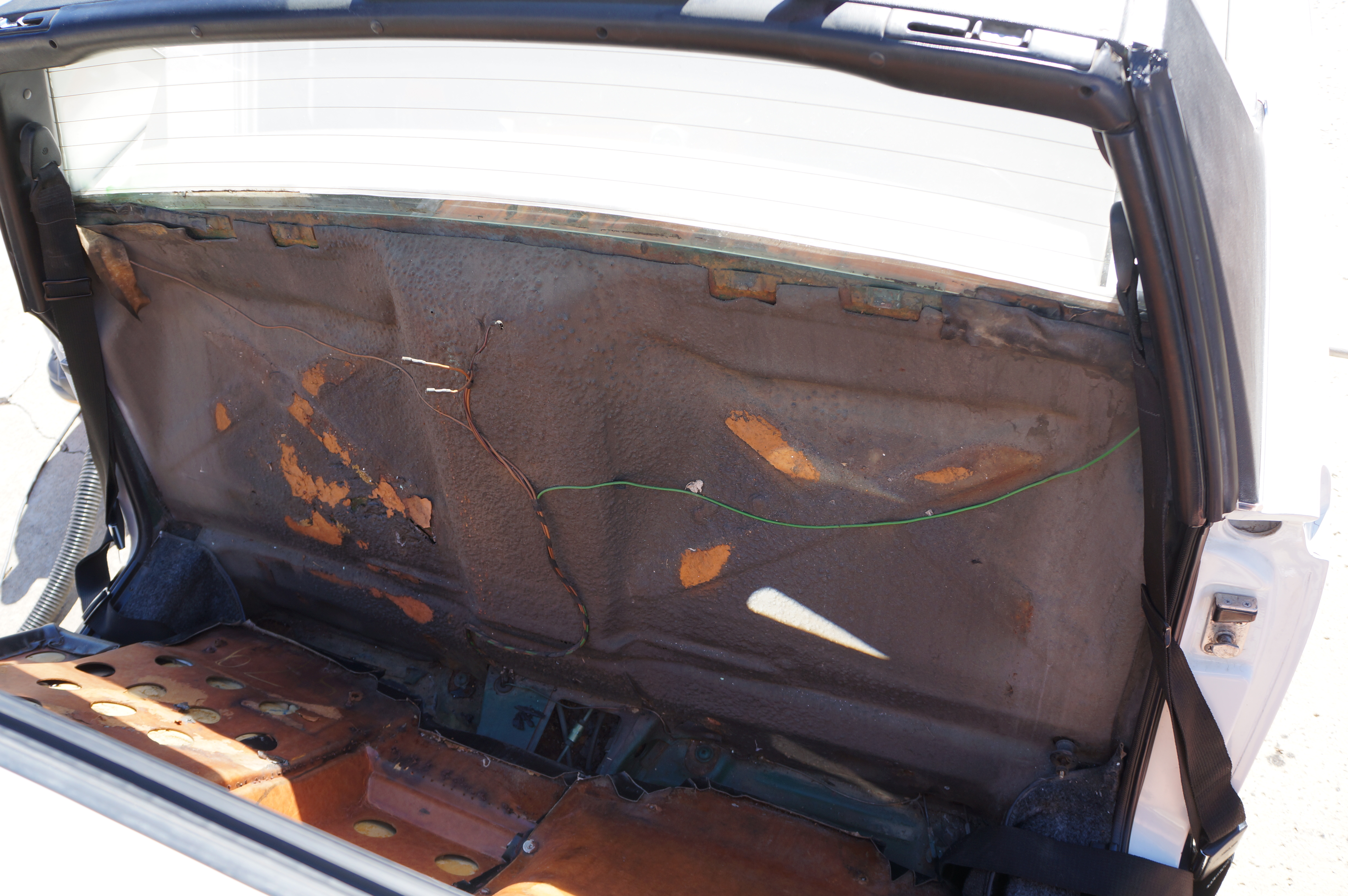

I haven't seen this before. Maybe it's just early car vs late car, but the thin sound padding on the firewall was sprayed/melted on. On all the later cars I've seen this is just a sheet the peels (usually falls) off.
-Steve

siverson   I haven't seen this before. Maybe it's jus...   Jan 5 2014, 11:24 AM
siverson   The wires were embedded in it a bit... -Steve   Jan 5 2014, 11:29 AM
siverson   Why you should fix a loose rear window... Especial...   Jan 5 2014, 11:31 AM
siverson   When I started to pull up all the tar. Note there ...   Jan 5 2014, 11:33 AM
mepstein   :confused: what your showing in the pic should j...   Jan 5 2014, 11:34 AM
siverson   > what your showing in the pic should just peel...   Jan 5 2014, 11:36 AM
