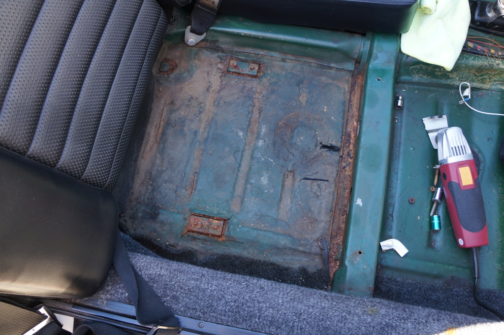

When I started to pull up all the tar. Note there are no "carpet hold downs" on the main floor board. They aren't on either side, but the factory tar is still everywhere.
-Steve

siverson   When I started to pull up all the tar. Note there ...   Jan 5 2014, 11:33 AM
mepstein   :confused: what your showing in the pic should j...   Jan 5 2014, 11:34 AM
siverson   > what your showing in the pic should just peel...   Jan 5 2014, 11:36 AM
rick 918-S   That's weird about the carpet holders....   Jan 5 2014, 11:50 AM
sixnotfour   my six has no carpet holders and factory carpet ha...   Jan 5 2014, 01:46 PM
siverson   > my six has no carpet holders and factory carp...   Jan 19 2014, 12:16 AM
