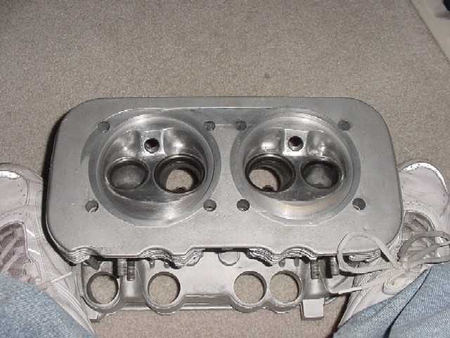

Well, I decided to take another look at the first head that I swapped out because i THOUGHT it was cracked when it exhibited the same problem I am having now.... (exhaust leak sound only when hot)
This head was serviced less than 400 miles prior to me swapping it out (new valve seats, new valves, new springs).
I cleaned up the combustion chambersbut found no cracks or any evidence of cracks. Where should I be looking?
When I look closely at the exhaust ports it does look like there was some leakage (both ports toward the middle of the head) it also looks to me like the heat exchanger ear made contact with one exhaust stud boss.
I am attaching some pics below...

JOHNMAN   Well, I decided to take another look at the first ...   Aug 1 2004, 10:05 PM
JOHNMAN   Pic 2   Aug 1 2004, 10:06 PM
JOHNMAN   Pic 3   Aug 1 2004, 10:07 PM
JOHNMAN   Pic 4 Notice the carbon at the exhaust ports (whe...   Aug 1 2004, 10:09 PM
JOHNMAN   pic 5   Aug 1 2004, 10:10 PM
JOHNMAN   Now I may be right back to square one, not knowing...   Aug 1 2004, 10:22 PM

JOHNMAN   Well i put my compression tester on my engine toni...   Aug 2 2004, 10:56 PM
Brad Roberts   The cracks in the 2.0 heads that we worry about ar...   Aug 2 2004, 11:25 PM
JOHNMAN   Brad, which view? I can always take more pics.......   Aug 2 2004, 11:50 PM
Brad Roberts   They crack going away from the seat in the exhaust...   Aug 3 2004, 12:06 AM
RustyWa   I've heard it's also a good idea to take a...   Aug 3 2004, 11:34 AM
Jake Raby   You can TIG up those cracks... Use more argon and ...   Aug 3 2004, 12:04 PM
JOHNMAN
  Aug 3 2004, 11:22 PM
Brad Roberts   I use 12mm copper nuts with M8 flat washers. When ...   Aug 3 2004, 11:55 PM
