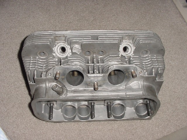

I am of the opinion that I have 2 cracked cylinder heads but am looking for advice....
I have a basically stock 2.0L engine (euro pistons & cylinders done 12 years ago or so), and have been noticing what sounds like an exhaust leak but only when the engine is hot (after driving at highway speeds for about an hour). After the car sits for an hour or so and is started back up, there is no more exhaust leak sound.
The exhaust leak seems to be coming from the drivers side so I am assuming that the driver side cylinder head may be cracked.
I have had the heat exchanger off numerous times and tried many times to seal it up better, but the last several times, I have not noticed any black leak marks on the copper gaskets. (So I am past thinking it is a leak between the head and the heat exchanger.)
One strange note: About 10 years ago, I had a similar occurance and I had a spare head so I had new valves and seats installed in it and I put that one on. I don't drive the car very often so I don't put that many miles on it over time.
Is it common for 2.0 cylinder heads (driver side) to develop cracks?
Can they be detected and repaired?
Who does a good job at finding and repairing them?
Do spark plugs sometimes leak when hot? (Come to think of it I haven't checked them in a while....)
Any and all advice/suggestions will be greatly appreciated.

Pic 3
JOHNMAN   Crack Head   Jul 29 2004, 08:56 PM
lapuwali   2.0 heads are indeed known for cracking, typically...   Jul 29 2004, 09:01 PM
Brad Roberts   Check the plugs first. Yes. 2.0 heads have some s...   Jul 29 2004, 09:01 PM
McMark   Compression leaks between the cylinder head and th...   Jul 29 2004, 09:06 PM
JOHNMAN   Thanks for the replies and keep em comming.... la...   Jul 29 2004, 10:18 PM
Jake Raby   90% of 2.0 heads have cracks.... They can ALL be...   Jul 30 2004, 07:02 AM
JOHNMAN   Well, I decided to take another look at the first ...   Aug 1 2004, 10:05 PM
JOHNMAN   Pic 2   Aug 1 2004, 10:06 PM
JOHNMAN   Pic 3   Aug 1 2004, 10:07 PM
JOHNMAN   Pic 4 Notice the carbon at the exhaust ports (whe...   Aug 1 2004, 10:09 PM
JOHNMAN   pic 5   Aug 1 2004, 10:10 PM
JOHNMAN   Now I may be right back to square one, not knowing...   Aug 1 2004, 10:22 PM
MarkV   Cold, warm & hot compression test ???   Aug 1 2004, 10:36 PM
JOHNMAN
  Aug 1 2004, 10:45 PM
MarkV   Good question, hadn't thought of that.   Aug 1 2004, 10:50 PM
JOHNMAN   Well i put my compression tester on my engine toni...   Aug 2 2004, 10:56 PM
Brad Roberts   The cracks in the 2.0 heads that we worry about ar...   Aug 2 2004, 11:25 PM
JOHNMAN   Brad, which view? I can always take more pics.......   Aug 2 2004, 11:50 PM
Brad Roberts   They crack going away from the seat in the exhaust...   Aug 3 2004, 12:06 AM
RustyWa   I've heard it's also a good idea to take a...   Aug 3 2004, 11:34 AM
Jake Raby   You can TIG up those cracks... Use more argon and ...   Aug 3 2004, 12:04 PM
JOHNMAN
  Aug 3 2004, 11:22 PM
Brad Roberts   I use 12mm copper nuts with M8 flat washers. When ...   Aug 3 2004, 11:55 PM
