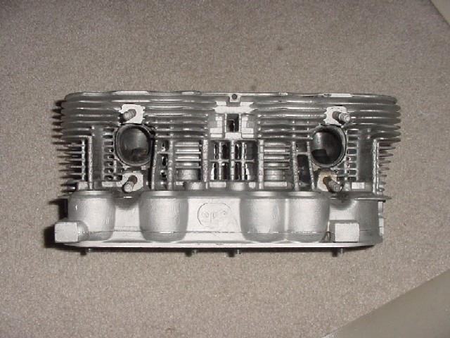

Pic 4
Notice the carbon at the exhaust ports (where the copper gaskets go).
Also notice on the right (#1 cyl) shows the contact made with the heat exchanger ear.

JOHNMAN   Well, I decided to take another look at the first ...   Aug 1 2004, 10:05 PM
JOHNMAN   Pic 2   Aug 1 2004, 10:06 PM
JOHNMAN   Pic 3   Aug 1 2004, 10:07 PM
JOHNMAN   Pic 4 Notice the carbon at the exhaust ports (whe...   Aug 1 2004, 10:09 PM
JOHNMAN   pic 5   Aug 1 2004, 10:10 PM
JOHNMAN   Now I may be right back to square one, not knowing...   Aug 1 2004, 10:22 PM

Brad Roberts   The cracks in the 2.0 heads that we worry about ar...   Aug 2 2004, 11:25 PM
JOHNMAN   Brad, which view? I can always take more pics.......   Aug 2 2004, 11:50 PM
Brad Roberts   They crack going away from the seat in the exhaust...   Aug 3 2004, 12:06 AM
