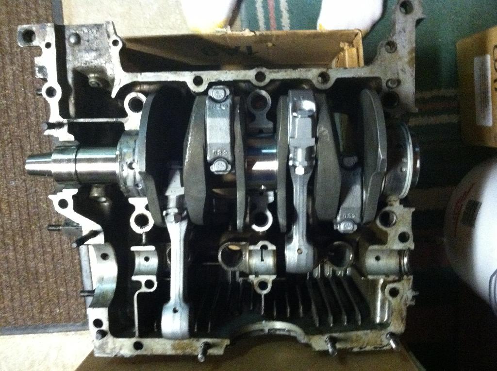

I am starting to clearance my rods to the case, my dad is worried that Ill need new rods.
he thankfully is my engine builder. having done a few before.

Dave_Darling   IIRC, the rods to the case is not usually a proble...   Jan 17 2014, 10:21 AM
