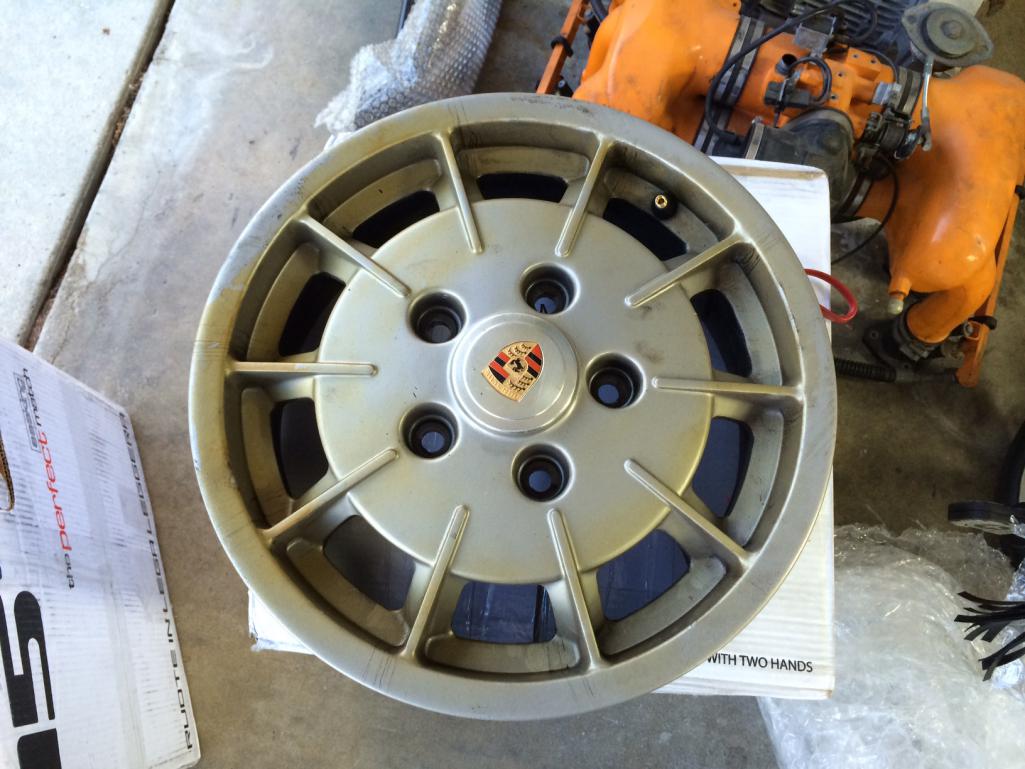

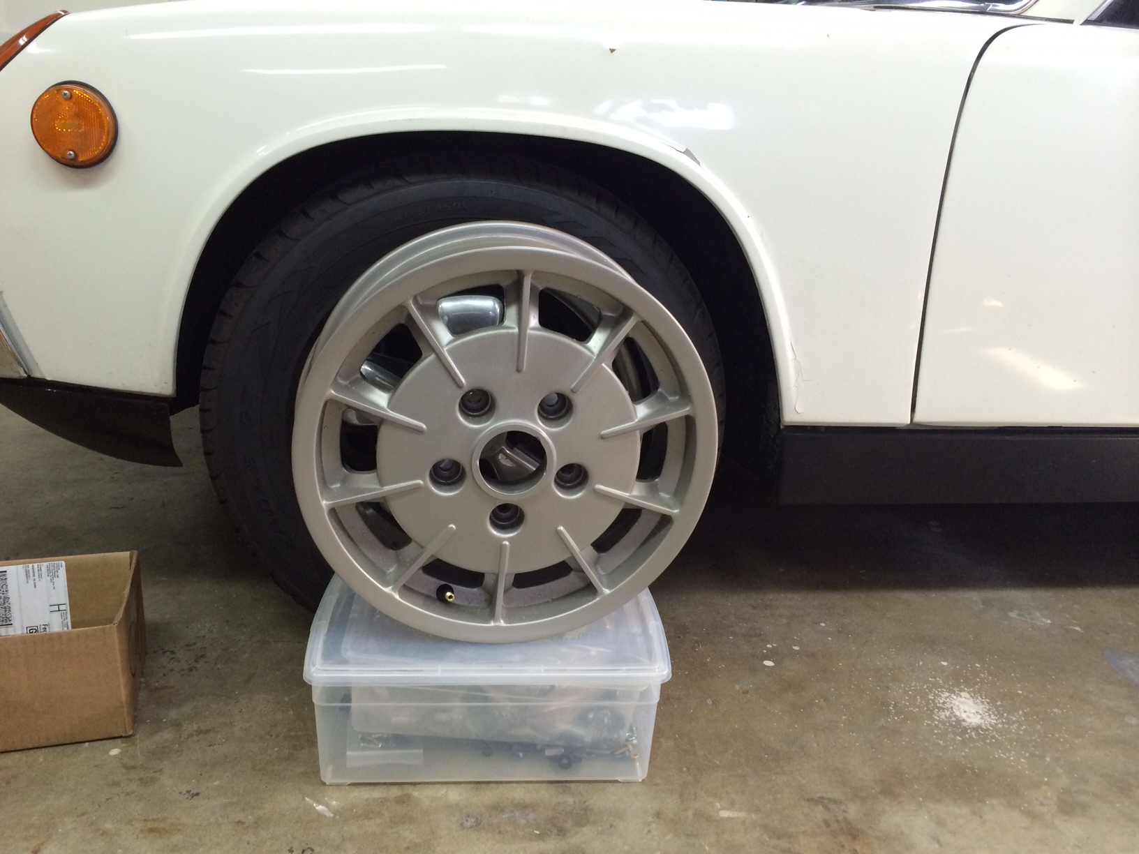

While I love Fuchs on 914s, and 15x6s are one of my favorites (great proportions), it's been bugging me that these aren't "correct" for a 914-6. So I've been debating going with 14" Fuchs or something different, but still correct for a 914-6.
These arrived today...
-Steve

914Sixer   Correct wheels can be a fuzzy area. They can fall...   Jan 19 2014, 09:39 AM
siverson   > Correct wheels can be a fuzzy area. Sort of...   Jan 19 2014, 01:15 PM
toolguy   That is correct. . .only 14" Fuch's howev...   Jan 19 2014, 01:20 PM
sixnotfour   My version of the Bible shows em, printed 1/74   Jan 19 2014, 01:58 PM
sixnotfour   I think wheel choice was a crap shoot, not an opti...   Jan 19 2014, 02:10 PM
siverson   > My version of the Bible shows em, printed 1/7...   Jan 23 2014, 10:44 PM
sixnotfour   Porsche printed parts list, yes the mahles are l...   Jan 23 2014, 11:07 PM

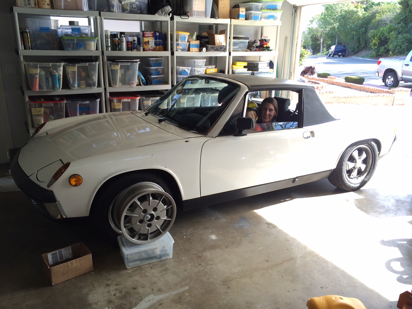

siverson   And one last "test ride" before disassem...   Mar 7 2014, 09:47 PM
ben*james   Way to go!   Mar 7 2014, 09:50 PM
