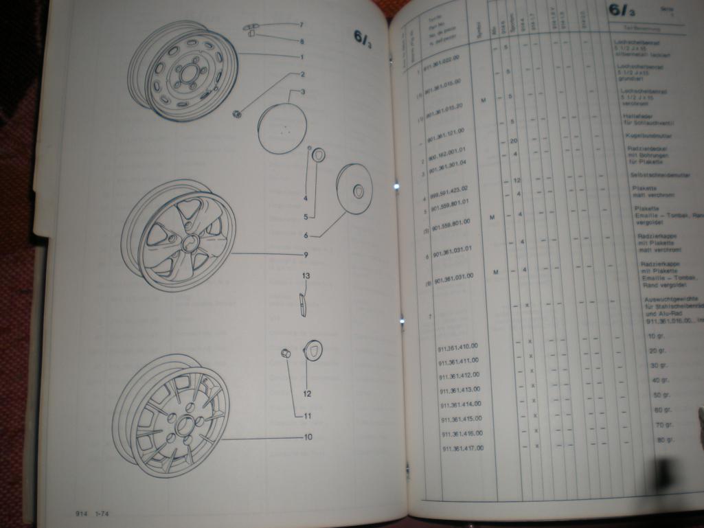

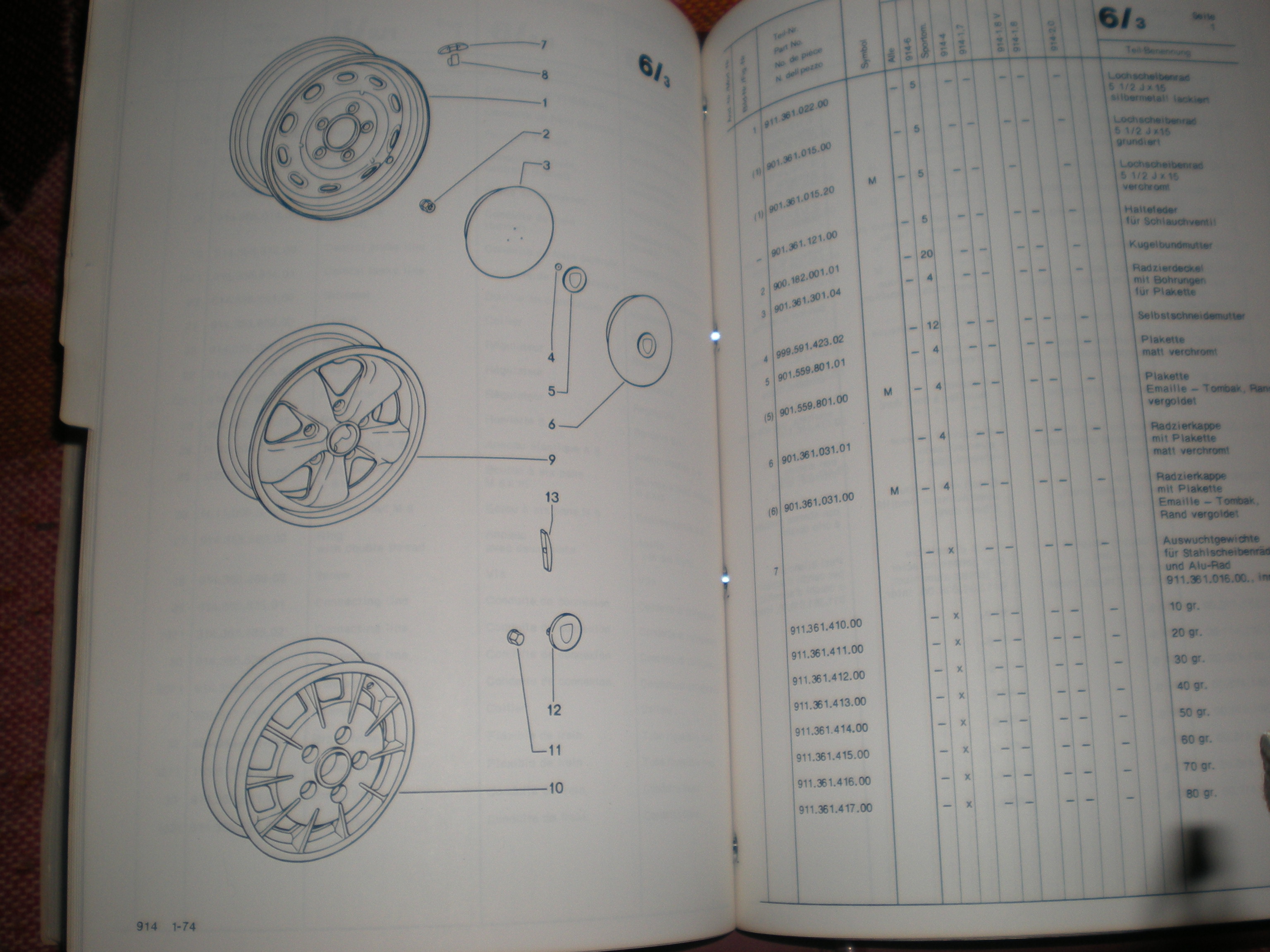

My version of the Bible shows em, printed 1/74

siverson   While I love Fuchs on 914s, and 15x6s are one of m...   Jan 19 2014, 12:23 AM
siverson   That's cosmoline in the first picture, but the...   Jan 19 2014, 12:25 AM
mepstein   I like the look of the gas burners. Mine weighed 1...   Jan 19 2014, 09:35 AM
2mAn   I like the look of the gas burners. Mine weighed ...   Jan 24 2014, 11:37 AM
914Sixer   Correct wheels can be a fuzzy area. They can fall...   Jan 19 2014, 09:39 AM
siverson   > Correct wheels can be a fuzzy area. Sort of...   Jan 19 2014, 01:15 PM
toolguy   That is correct. . .only 14" Fuch's howev...   Jan 19 2014, 01:20 PM
sixnotfour   My version of the Bible shows em, printed 1/74   Jan 19 2014, 01:58 PM
sixnotfour   I think wheel choice was a crap shoot, not an opti...   Jan 19 2014, 02:10 PM
siverson   > My version of the Bible shows em, printed 1/7...   Jan 23 2014, 10:44 PM
sixnotfour   Porsche printed parts list, yes the mahles are l...   Jan 23 2014, 11:07 PM
