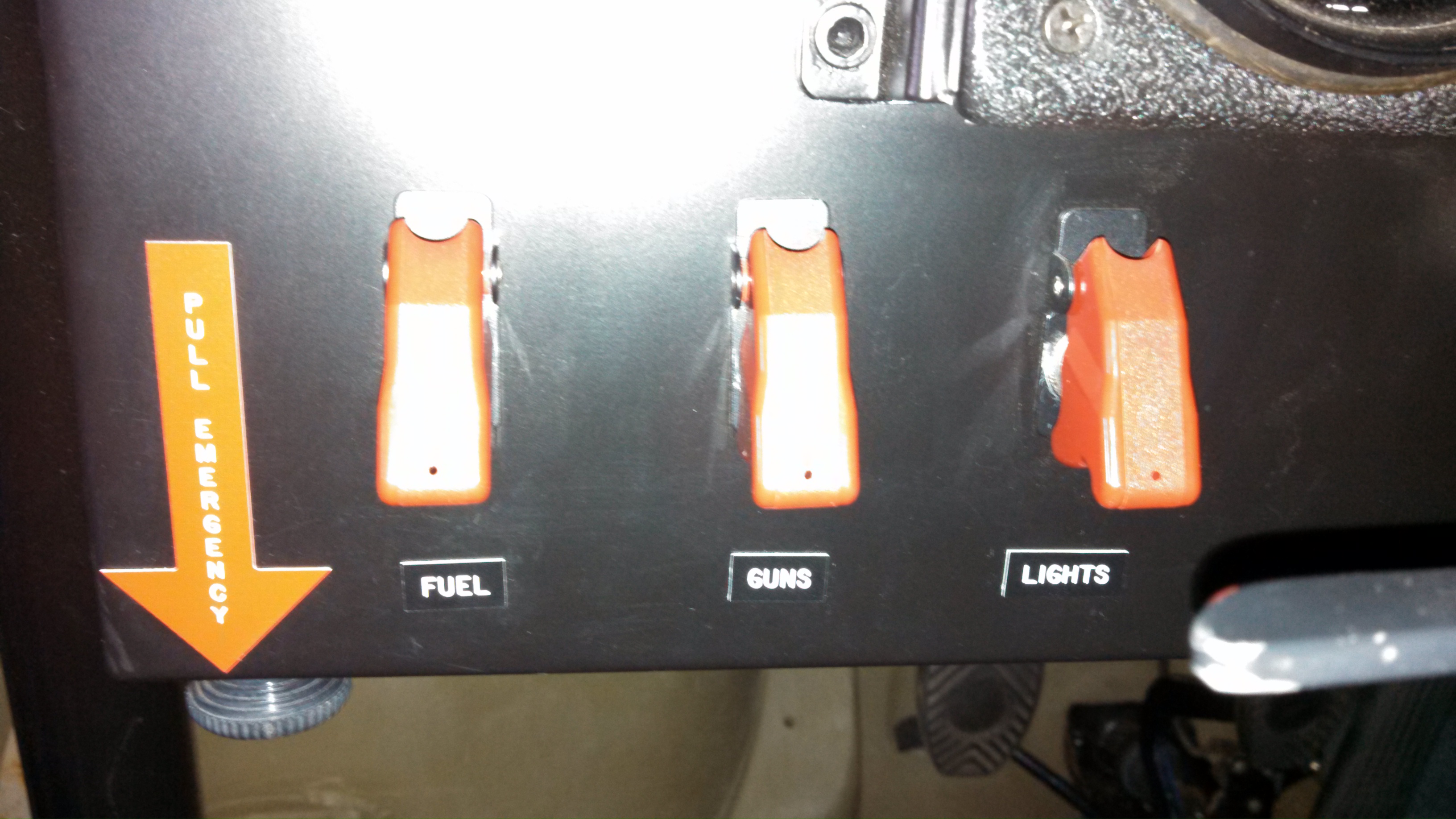

Krieger   For fun I had some placards made at Aircraft Engra...   Jan 19 2014, 02:31 PM
3d914   Nice touch! I hope those guns are rear-mounted...   Mar 28 2014, 12:43 PM
