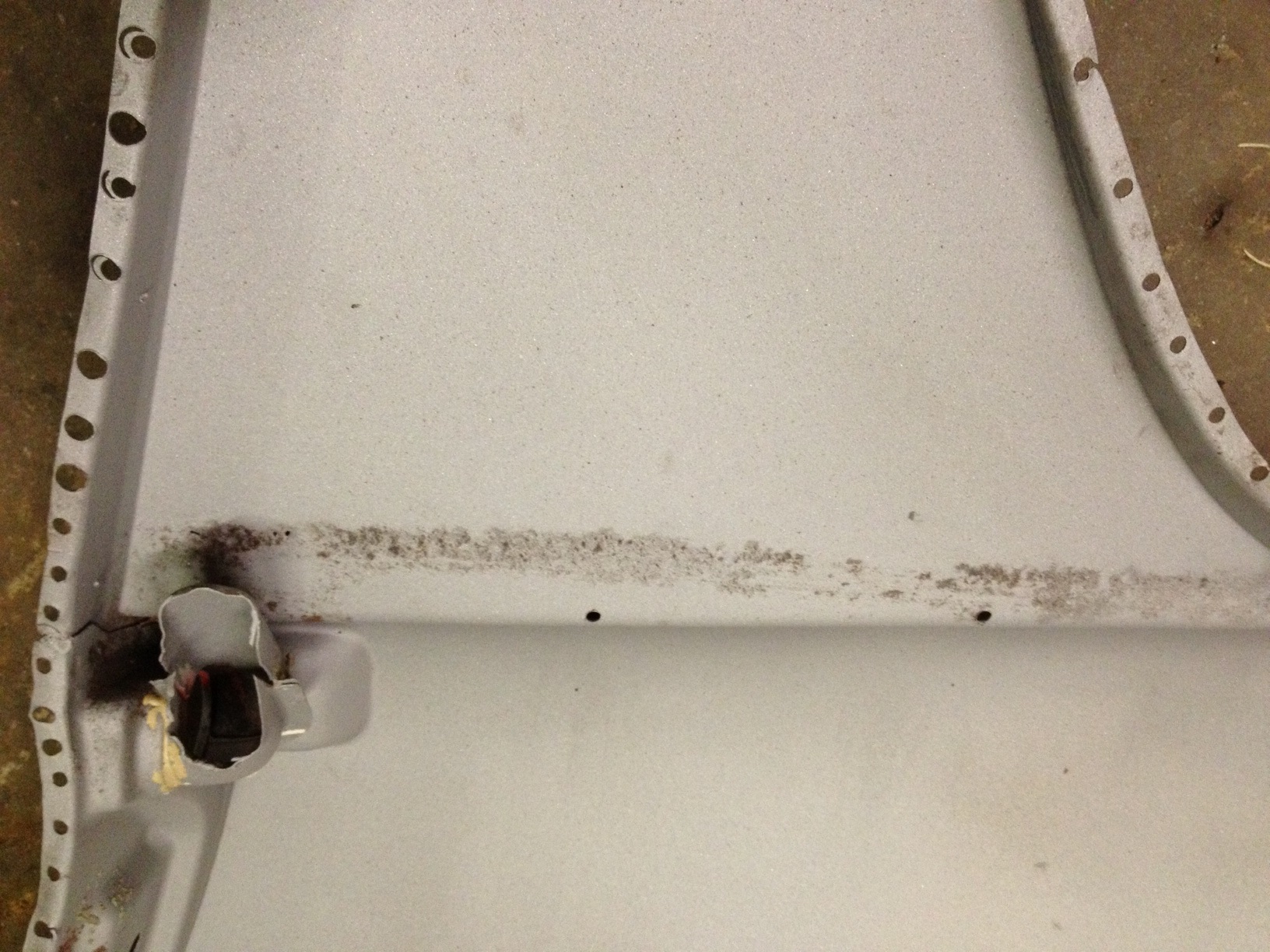

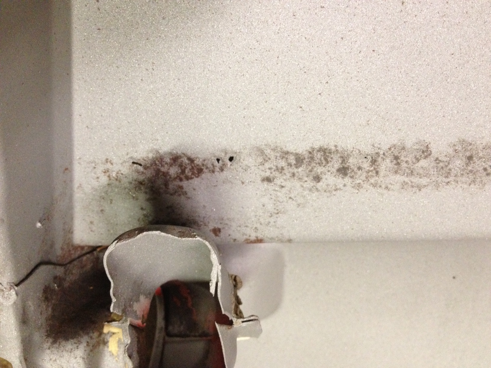

I am getting ready to install a used sail panel/lower fender section. It is in good shape except for some internal rust from the internal foam weather stripping. There are only a few minor holes that extent to the outside of the panel.
I need suggestions on repairing this before I install it. Should I weld or braze the minor pin holes shut and then use a fiberglass body filler to fill the rest of the imperfections?
