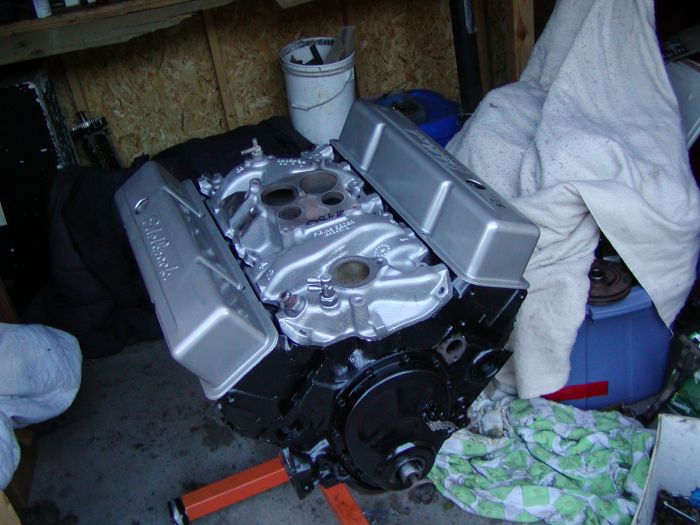

Heres an update...
Got the parts from Steve (very much earlyer than I expected. Thanks!!!)
I have the bottom end assembled, the top end... well, silly me, I cant fine a stupid head bolt.. I assume I wont find one at the local flaps... So Im just going to hit pick and pull.
Engine's painted... I'll paint, or clean the carb (depending on how bad it is..) and paint the air cleaner junk black with silver accents..
Should look pretty darn good!

Andyrew   Heres an update... Got the parts from Steve (very...   Aug 3 2004, 09:01 PM
