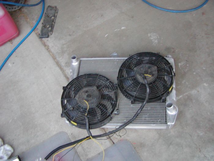

The twin (huge) fans that I got from Steve... I think I'll just use one.. there 15in...

Andyrew   The twin (huge) fans that I got from Steve... I th...   Aug 3 2004, 09:15 PM

dan10101   Radiator... DONE (minous wiring the fan...)   Aug 30 2004, 09:27 PM
skline   Why does it look like its going to leak??? Are you...   Aug 30 2004, 11:26 PM
Andyrew   Oh the hoses arnt connected all the way.... air es...   Aug 30 2004, 11:55 PM
neo914-6   Scott, You must have missed the vented hood pic.....   Aug 31 2004, 12:08 AM
Mueller   hey Andrew, that ugly front bumper sure looks fami...   Aug 31 2004, 12:40 AM
