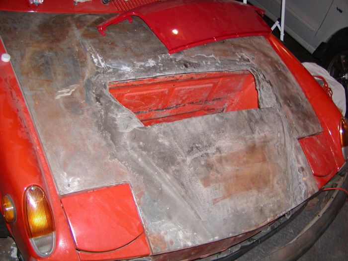

hehe... I know im going to be shot down for this one. But here goes nothing.
Steve dropped off this front hood, and honestly, I really like it! It will create a pull from the front hood, and it will allow for air to escape smoothly. Later on I'll cut the fender wells, and reinforce that area because of the strength lost from cutting the fenderwells.. But currently I think this will be perfect. Its a perfect design for my radiator and fan setup as well.
I will be putting a grill in the opening, adding another layer of fiberglass to fill in any trouble area's, and for strenth, and finishing so it looks nice, and painting it all body color.
ITS FUNCTIONAL..... Im no ricer..
Let me know what you think.

Andyrew   hehe... I know im going to be shot down for this o...   Aug 3 2004, 09:21 PM

Andyrew   today was... A productively bad day... lol Im qu...   Aug 7 2004, 09:26 PM
Andyrew   Oh I guess I could post some pics.. Dad rebuild t...   Aug 9 2004, 12:13 AM
Andyrew   In the above pic, the top two pieces are for the s...   Aug 9 2004, 12:20 AM
Andyrew   And heres the hole... Not that big, but it should ...   Aug 9 2004, 12:23 AM
Andyrew   And here's the 916 bumper that will have its h...   Aug 9 2004, 12:26 AM
