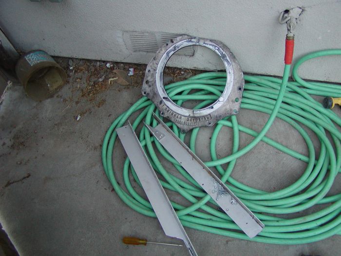

Adapter plate for the later model v8 (86 and up to the LS1) that will be for sale on ebay or whatnot soon. also the rails that hold the two radiator fans together.. Dont think im gona use it.
