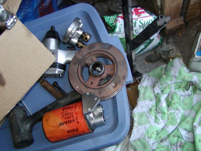

Cool trick stuff.
Harmonic balancer from renegade or whatnot.
and hehe, remote oil filter, which I will tap into the lines and add a oil cooler, Yup, I dont want any over heating problems, my big ars aluminum radiator, big old fans, and this oil cooler, should prevent any of that problem. Besides all the engine stuff is clean, hot tanked, and everything should flow very nicely.
