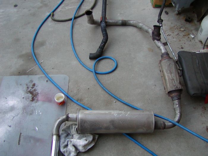

Boring single exhaust... One cat, one truck muff.. first few miles im going to do will be taking it down to a nice muff shop, and having them take out the cat. Shouldnt be that hard, not that much money.
Later on I'll spend some cash and do a nice, cool sounding dual exhaust. We have some interesting idea's....
